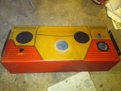

Can someone with a compact pleas epost up photos of their control panel? This abort button off my panel does not look correct. Was the abort button not square and light up? Maybe I'm making things up.....

I don't have pics handy, but its a lit volcano button, at least on the compact.

I had the same issue on my compact Hard Drivin', a previous owner / operator replaced the correct LED / Volcano switch (Licon at that point not Cherry brand - same type switch) by "crudely chiseling out" the CP and puting in a round push button leaf switch. Of course, also cut the wiring to it and the plug off. It was a mess. At first I found a way to patch the hole using a heavy piece of white plastic I had, left over I think from new siding parts on my house. Cut it and it covered the hole nicely (Yes I had to metal screw the plastic down to the CP) then I drilled out a hole in it to put the correct Licon Volcano LED switch back in and made a new wiring harness and hooked it all back up. Worked great! Stlll I wanted the game back as it should be. Fortunately for me at the time, about five years ago, there were several Compact Hard Drivin's being parted out and posted on eBay. I bought a near pefect complete control panel and replaced it. Also found a complete wiring harness and replaced it too. Photo as it is now back the way it should be. :)
That control panel looks great! Sadly, I think I'll have to look at another option, perhaps a small red illuminated Square button, assuming the button is indeed illuminated from Factory

It is illuminated from Atari Games - factory. It is a Licon ( Cherry should work to just fine too) LED volcano switch button. It flashes when the instant replay is activated (resulting from you crashing your car) and you, obviously, push the button if you do not want to watch it.
Edit / add: The sit down / cockpit version had a square lighted push button seat adjust switch - Maybe you could put one of those in it?
Stephen at Arcade Fix it still has NOS ones. Maybe email him and ask the size and specs. It should be lighted and a single pole single throw switch (N/O?). Maybe you can get the "Seat Adjust" label out of it too. Just a thought.
