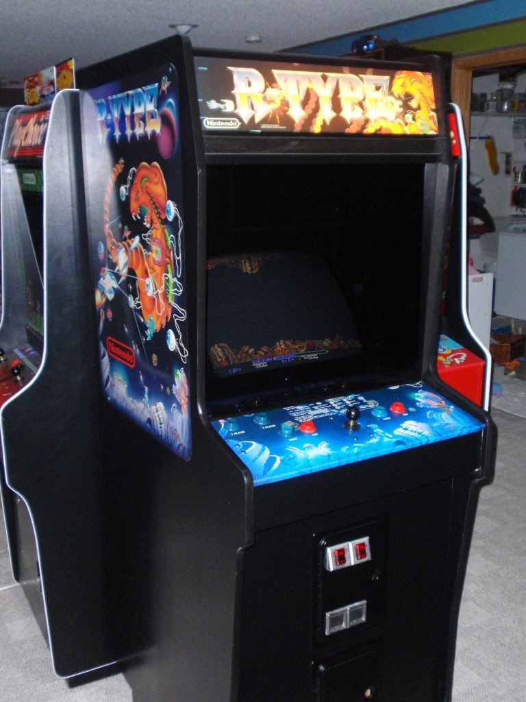

R-Type Restoration
Awesome as always. Excellent job on eliminating an edge to the existing artwork. Now I want one!

Looks good man, and its probably refreshing for you not to have to completely tear a game down to make it look real nice. I'm also guessing since this cab was black, it made the painting/feathering w/ the artwork much easier than the Popeye cab you did?

This paint job was awesome. I rolled on 2 coats of Rustoleum semi-gloss oil-based black cut with 10% penetrol sanding with a 180-then 320 grit sanding block between coats. I then hit it with 320 again, then used 2 grades of steel wool, then rubbing compound, then polishing compound, then a power buffer, then a hand buffing, then glass cleaner to get the finish smoother than Fritz's coinpurse after a sasssy salon visit. I then polished and sealed the cpo, cross piece and kickplate paint with Armor All. Turned out really nice. The back door, bottom panel and roof OSB (oriented strand board-ugly shit) was also painted semi-gloss black. The inside was cleaned out, scrubbed and all stains sanded out. Looks pretty new in there. The only thing I still need to do is repaint the monitor chassis so Chris doesn't yell at me.
