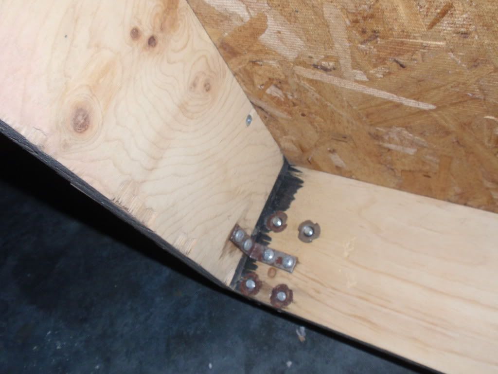

Yep, it has a 4.5" high base on it, 22 3/8" wide by 22 3/4 long. They were originally made from cheap 1" plywood strips with rabbit joints joining them at the 4 corners. I used 3/4 SPF boards and mitred the corners 45 degrees, adding 90 degree wood wedges for strength. I then cut 4 - 5/8" square dowels 18 3/4 long for the mounting frame, securing them the cab floor with wood glue and 1 1/4" crown staples. Then I placed the base around the dowel frame and secured it to the dowels with glue and the same staples, driven sideways from the inside of the dowels. What's weird on these cabs, is the the moving wheels are fastened to the back baseboard with 1/4" T-nuts and stove bolts. I reproduced this on my base, but I inset the wheels an inch further in, to compensate for the corner wedges:
Before:
After:
