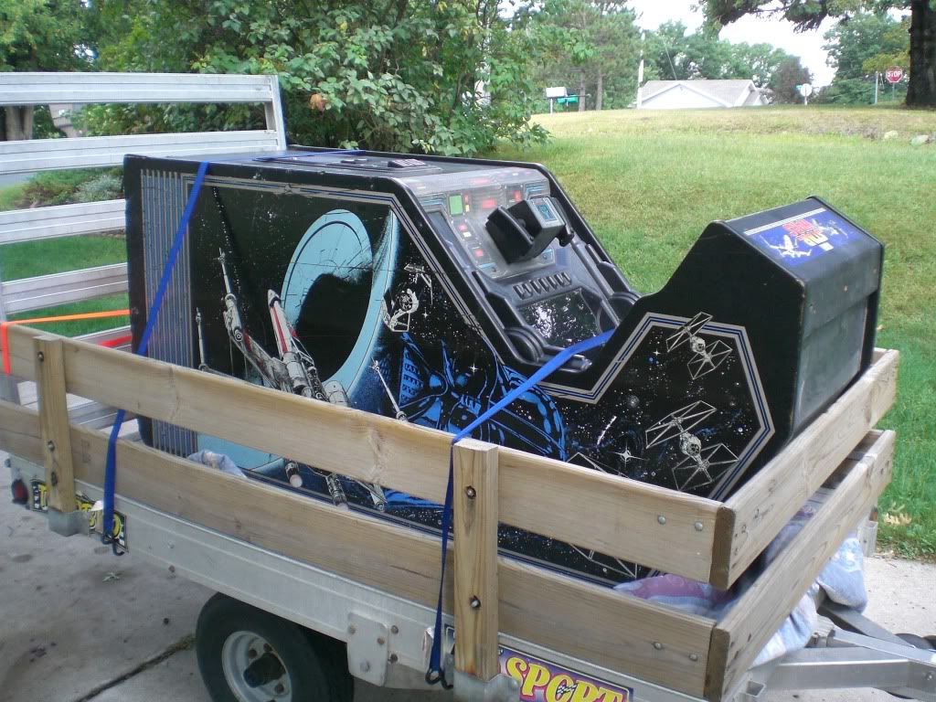

And.....it's mine :)
It's in pretty rough shape (especially the bottom).
It'll likely need a new bottom plate fitted to the cab. All 4 leg levelers were ripped out at some point, and there are just holes. The rear bottom plate is also separating from the back too, but that's a common issue I've seen with Atari cabs in the past.
A little bit of TLC with the clamps and wood glue should get this cab sturdy again. I'll probably just throw a Bob Roberts leg leveler kit on there if I don't replace the bottom. We'll see.
Owner told me it was HUO machine, but you know how THAT story goes.
It's got a Wells Gardner 6100 in it, and the label on it says it's from a Major Havok. All of the original mounting strips are still there from the Amp High Voltage pcb and deflection pcb's so this game had an Amp in it at one point, but not any more.
Owner told me that the sound quit on it first, then one day it wouldn't turn on any more. Probably needs an AR-II rebuild.

Replacing those blind nuts is easy enough, Atari originally used heavy staples to retain them, which often ripped out.
I like to use a pair of round head #8 or #10 screws, about 3/4" long, mounted on opposite sides of the blind nut, so their heads overlap the edge of the blind nut. You'll need to use a #3 drive bit for these larger screws, but you'll have no more worries about blind nuts & levelers falling out when you move your game.
On some cabs where the holes aren't too bad, I've put t-nuts and held them in place with those big staples you use to mount Romex wire. Seems like I've had leg leveler issues mostly with atari cabs.
Unfortunately, that's not going to work in this case. The blind nuts AND staples have been completely pulled out in 2 holes. The other two are present, but in really rough shape.
I'll probably replace the bottom of this cab.
