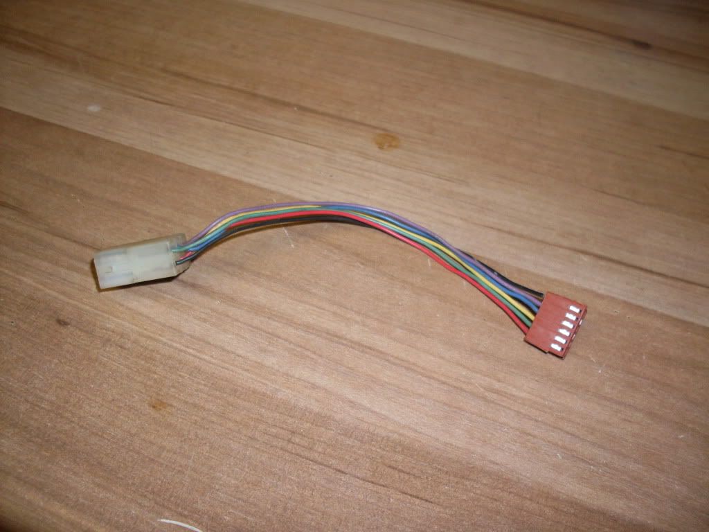

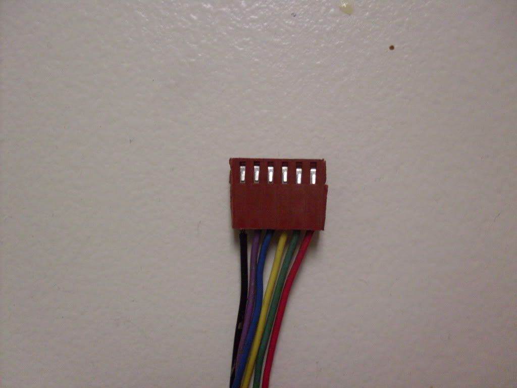

Here's how the wiring should be to the Molex that plugs into the trackball connectors on the 60-in-1 board. CON3 is for Player 1 and CON4 is for Player 2:
I have a mini harness that I use on the bench. Used in a cabinet, the wires would normally be about 4 feet long...

Look at the picture of the connectors in the manual, then rotate your board so that the connectors on the board are labeled and numbered in the same orientation as in the manual, then make sure the ground and +5 wires are to the proper pins.
