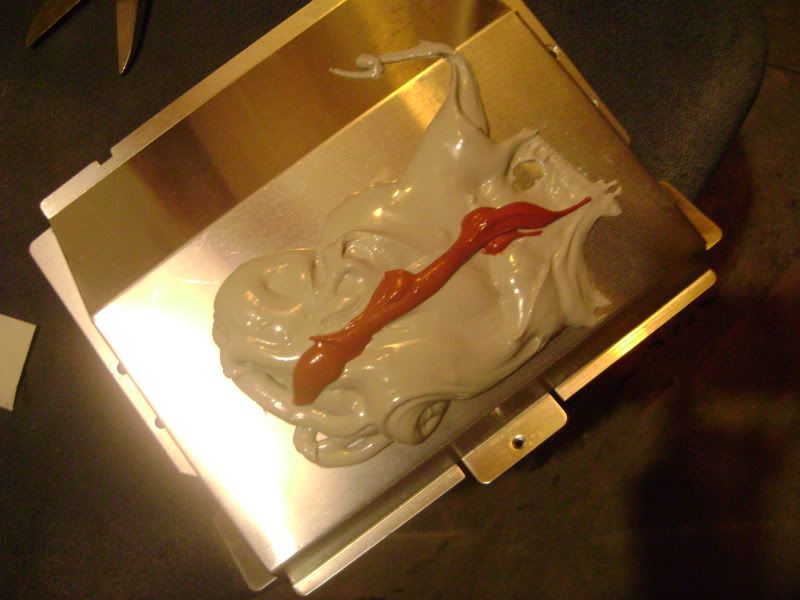

I think the mfg includes enough hardener to do the whole batch...if you mix it perfectly and at optimum temperature. Which never happens.
rule of thumb is a circular dollop of filler.. then a strip of hardener almost but not as quite as long as the central diameter of the bondo
basically lay a strip of hardener across the top of your bondo, dead center. but not quite all the way across, if that makes sense..
if the stuff is bright red and hardens up in one minuite, you added too much hardener
Usually the hardener tube they include is not enough. If you use sparingly maybe, but I always use more so it will have a faster and harder set up. If you don't put enough in it will set up like rubber and will be unable to work with it.
It is the right amount in the little tube. It Takes a little practice on the amount to put in. Too little will take longer to cure but it will cure. Too much sets up fast with pin holes.. Example, Yellow bondo, Blue hardner , You should end up with a Med. Green when mixed. Hard to tell you how to do it But I have been spreading Bondo for over 30 yrs.

rule is golf ball size per half inch of hardner..

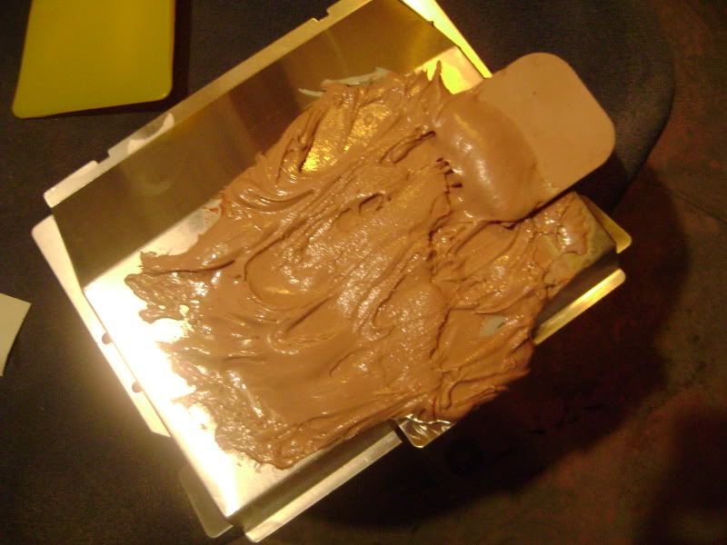

I always have hardener left when I get finished with a can. If you mix it so that it's just light pink it will take 15-30 mins to harden, but it gives you time to apply and shape. I just put a dollup (sp?) down and put one stripe of hardener about 2/3 of the way across. This rule of thumb works well most of the time, but every now and then I end up with too much. Time is your friend. Don't rush it.

here is what usually do, its not rocket science!!!

If you buy the Bondo brand of plastic spreaders, they are colored to match the correct ratio of resin to hardner.
Start off with a small amount of hardner, mix it well and compare it to the spreader, add more hardner as needed. Eventually you'll just know from experience, but matching the spreader is a good starting point.
The most important things to remember whenever working with resins are ratios and complete mixing. Get those right and you'll get great results.
