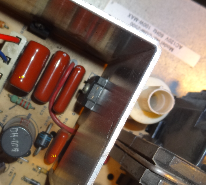

I found C706 (0.39uF 400V) and C716 (0.01uF 630V). C716 comes directly off of a post of the horizontal coil then to ground on the pcb. I'm going to replace both of these, but the ones close by look like they need to be replaced also.
Either check shorted?
extreme change in the value means its bad too.
most DMM has cap checker. but replace it anyway.

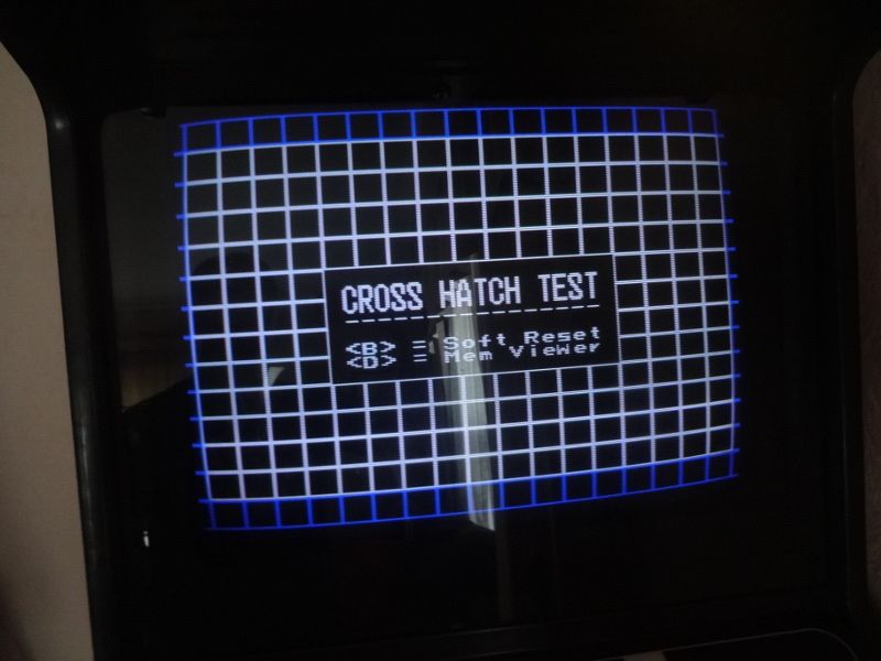

The image is to wide.
The tube is a 25" in a NeoGeo 4 slot cab.
Here is a pic of the test screen:

There should be 19 squares across from left to right, so the image is too wide. I have the image centered, but one square is cut off on each side. There is no jumper for width, the only adjustments are the coil and the pot on the remote board. The pot only reduces the width slightly. About half way through the pot adjustment there is no effect on the width. Could the pot be bad?

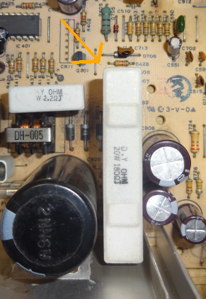

Here is a pic of the 20w resistor, is the arrow where I should check the dc voltage?
No but. You can remove the pot and measure the ohms as you slowly rotate the pot.
The test point is at the other end of the resistor or on the bottom of board.
Another test point is the r710 3 watt resistor going into the Horizontal transformer its up by
the horiz-pot one side is the B+ and the other is 12vs.

Just tested both sides of the r710. The right side was 87.2 and the left side (next to the metal fin) was 181.6. Looks like it's too low or too high? My multimeter was on 200v dc.
Also the capacitor in 799 was the one for 909? I did put in a cap for 799, but that didn't help. The cap for 799 must be 4.7uf 50v bp. c799 is on the board pic, but not in the board schematic. The reverse is true for c909, in the schematic but not on the board. Interesting... Maybe it is a typo.

The regulator is a str30130
get the datasheet via google str30130
it with show the pin config so you can test the output of the regulator
or measure at the other side of the 20watt resistor.
easy to get to from the bottom of chassis but not that easy from the top.
just to make sure test the voltage at the regulator.
I soldered a wire to the other side other the resistor on the bottom of the board. It measured 160. Looks like I need to replace it. I wondering where I can get one from? (180 5% 20W cerment resistor)

Update: After reflowing over half of the board and replacing c799 with a 63v, there is more adjustment in width. I wondering if this chassis was connected up to a 26" monitor, maybe it would be fine.
