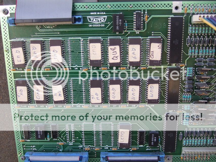

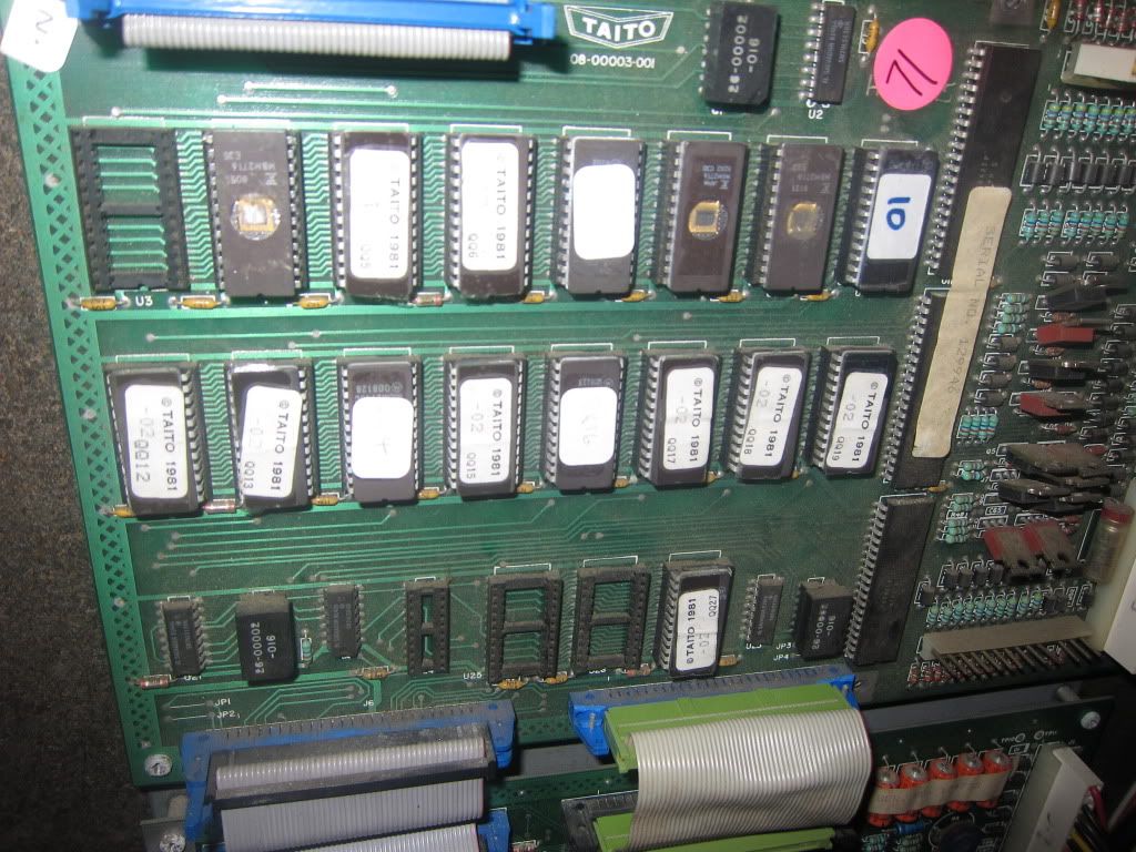

Anyone got a working one, or one with the complete ROMs? Looks like this may be the final culprit to get my game working...or it could be a ZK anyone can clarify?? See pic:

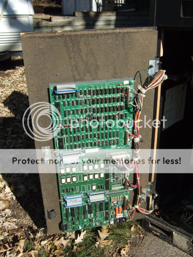

Here's a pic of it when Allen had the original PCB set in it running:
Label is backwards, the Roms are all facing the same direction. Looks like I'm missing Q1 for sure...
it also appears to be two different revisions.
as one has all sockets in it and the other one does not have the 4th and 8th socket there. witch means less roms.
i am no expert on theses board sets dont even own one just an observation.

Seen that too but I guess that called for other revisions and also to do modifications over to a ZK boardset as well..
I know that there seems to be a couple romsets for qix. One leaves a couple of the sockets unpopulated. I dont remember which two but I have that set in my machine.
Here's a better picture of the ROM PCB that was in the cabinet when I had it and it was working (we already know the guy I traded it to wanted it ONLY for the working boardset)...
Mine was obviously different from the one described in the Qix 'Theory of Operation'.
According to that, you are most assuredly missing U3:

There is another recent post that I posted about the different romset that leaves those three spots unpopulated. I would still pull and verify the roms but I doubt your missing any.

Yep... the other thread... I saw that. So that means there are at least 3 types... the two that are pictured and the one that the Qix manual explains and shows (which is neither of ours).
Still... if you are sure it's a problem with that PCB... pull the roms and verify them.
