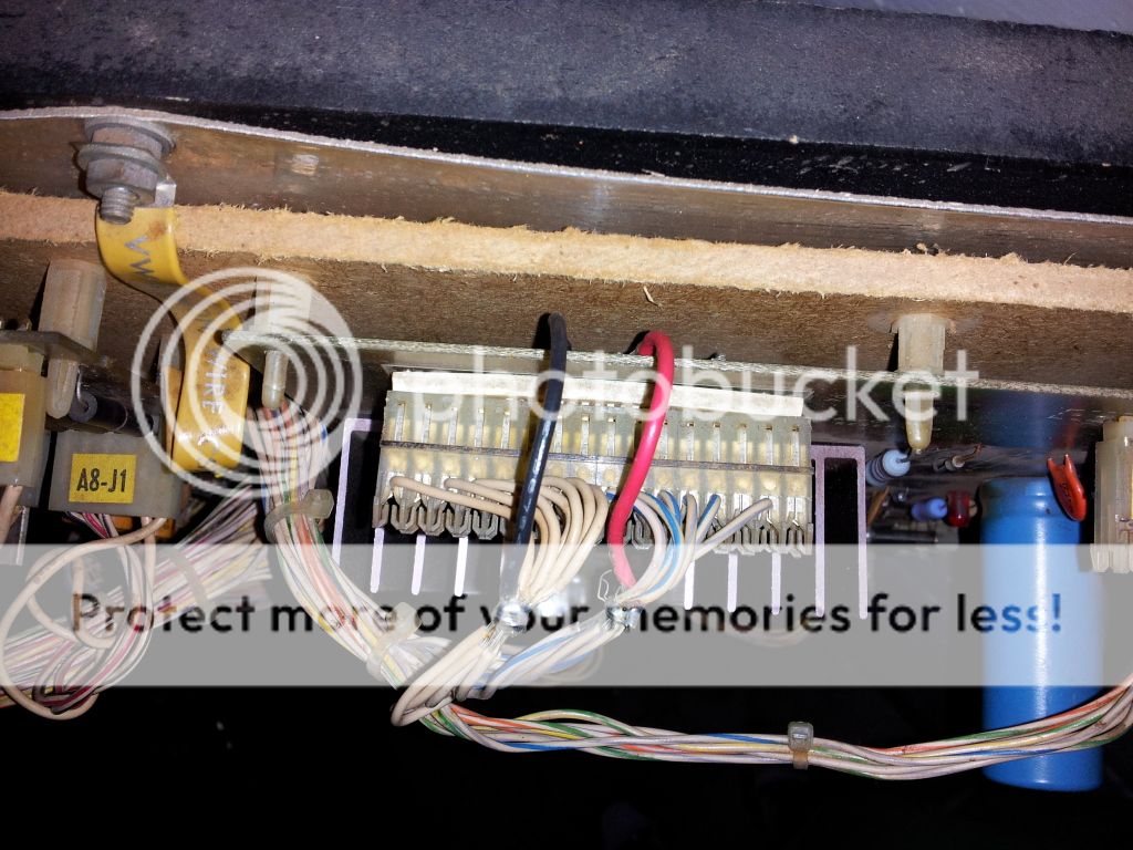

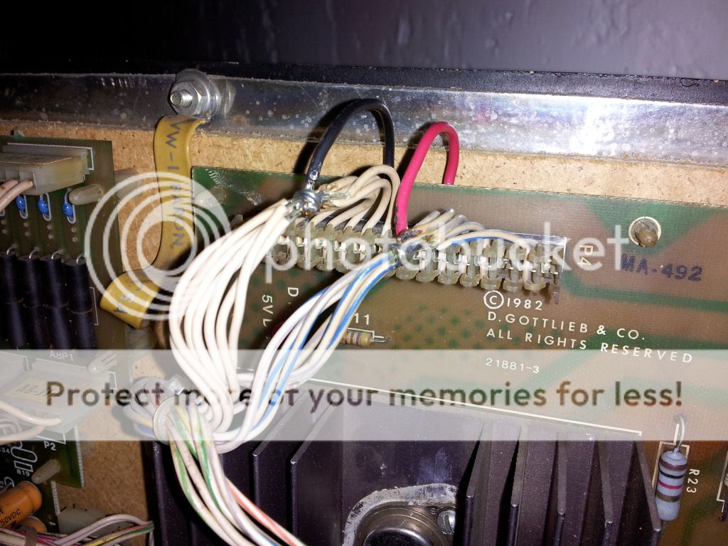

So I took a closer look tonight at my power supply bower and there are two wires that are soldered to the back of the board and to one of the connectors. What's that all about?
