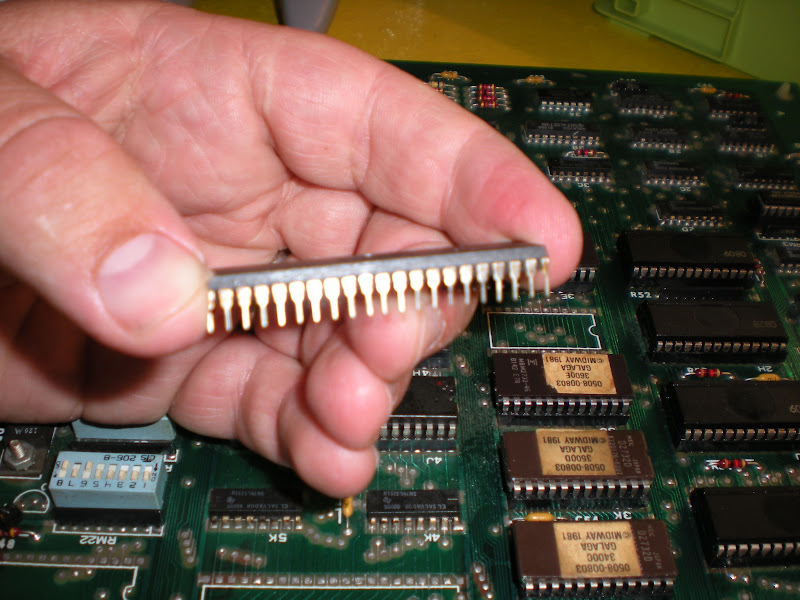

When I bought my Galaga it wouldn't get past the RAM OK screen, so I pulled each chip and cleaned the pins with a square eraser and deox one at a time:

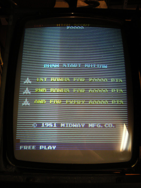

I would test each every 5 or so chips so I would know if I messed something up where it was, and when I was about 3/4 throught the chips I got it to this:
Wahoo%21%20Got%20Galaga%20past%20%22RAM%20OK%22%20message%20--%20continuing%20the%20process%20of%20pulling%20each%20chip%20and%20cleaning%201%20at%20a%20time..jpg

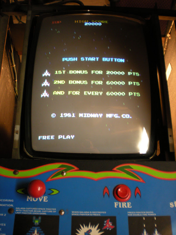

And then with the last chip:
...And%20when%20I%20was%20done%2C%20SUCCESS%21%20%20%23Galaga%20up%20and%20running%21%20%20Now%20I%20need%20to%20clean%20the%20cabinet%20and%20put%20it%20back%20together%21.jpg
This was thanks to Arcadeshop's Galaga page:
