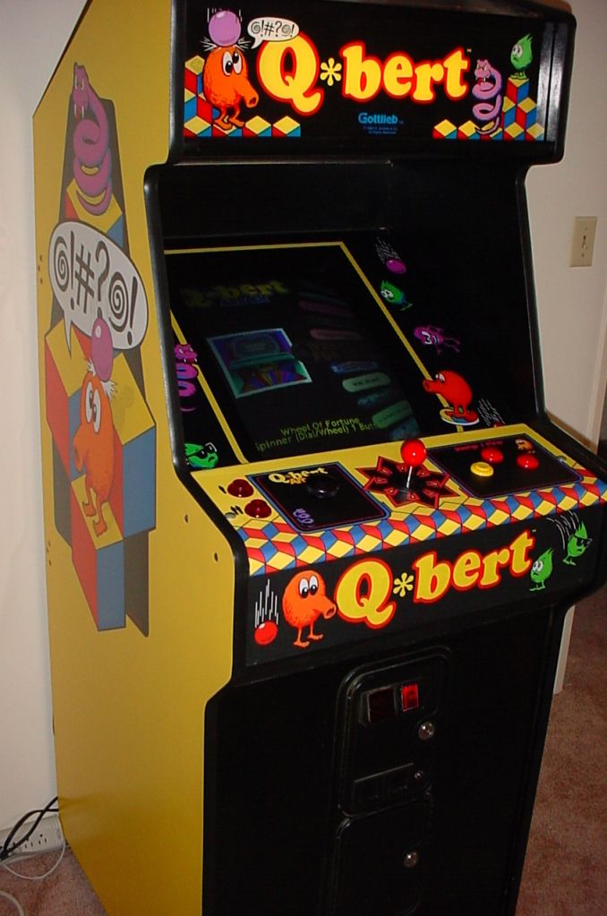

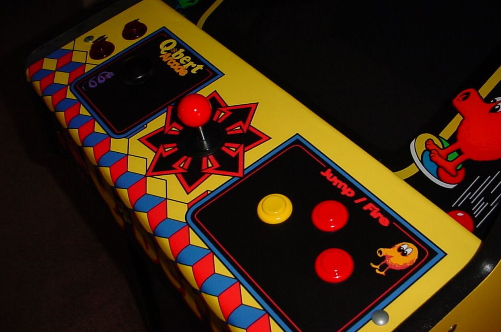

A lot of people have been bagging on MAME set-ups recently. I built mine a few years ago but I wanted to show what tasteful MAMEing looks like. It uses the Ultimarc Ultrastik which shifts programs depending on which games are loaded(2-way, 4-way, 8-way, Diagonal, Analog, 49-way)
The machine can be swapped back to stock in about 20 minutes.

Yeah, a few horizontal titles adjust and play perfectly vertically - Moon Patrol, Mario Bros., City Connection, Pepper II, Jungle Hunt to name a few. It's 99% vertical only though. That's the key, accepting the limitations of your set up and optimizing it for whichever screen orientation and panel space that you have. For instance, there isn't any game that I could find that uses more than 3 buttons that I give a crap about.

Nail, meet hammer... This is what sets apart a tasteful, fantastic looking semi-stealth Mame cabinet from the craptastic monstrosities with the surfboard control panels that most people associate with Mame. Beautiful job, very well done sir. I also use the Ultimarc Ultrastik in my DK Mame cab, it's awesome.
One question, I can tell from your video that you're running Mala (the "Starting..." window gave it away;)) but your pics show what looks like Hyperspin, but I didn't think that was able to do vertical. It's been awhile since I've been active with anything Mame related, though.
How does Pac-Man play with the Ultimarc Ultrastick? How does Mame handle it?
The ultimarc Ultrastik 360 is automatically set to 4 way when pacman is selected.
At least it is when your frontend is compatable with it.
I use Mala and a small program called ultrastik mapper available for it that will switch the joystick ON THE FLY to whatever the game is designed to use. 2 way for Defender, 4 way for pacman, 8 way for Robotron, Diagnals for Qbert...etc.
Awesome joystick. I make sure to get the heavy duty spring.

The Hyperspin frontend was early in the build. It was really wonky and they dropped support. I use Mala now and it works great.
