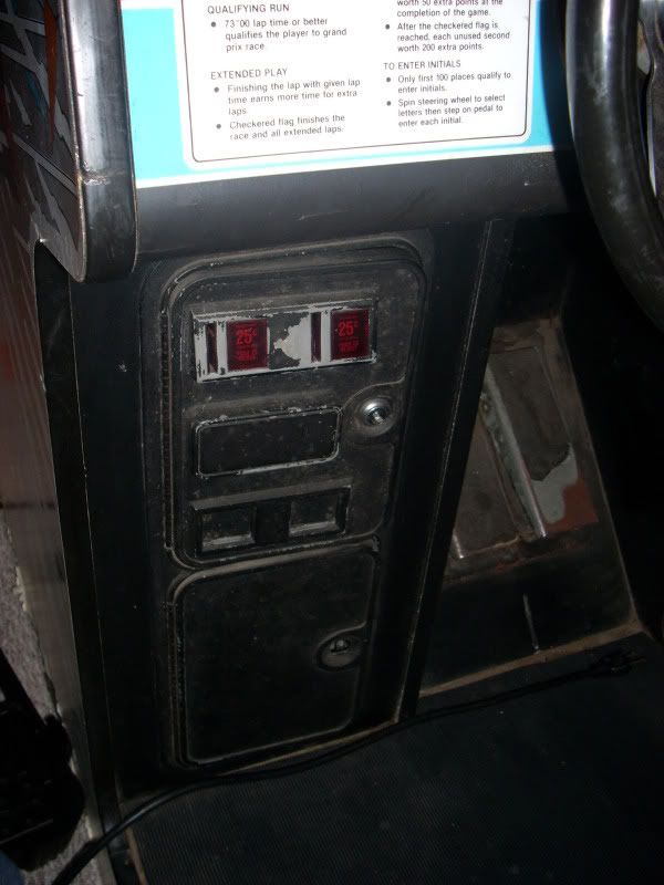

My second question is about the Gottlieb coin door. Is this just a regular over/under door that has that raised plate on it? Can I just find the plate and attach it or do I need to hunt down a complete door? I should note my Pole Position cockpit has a door with a raised area like the Gottlieb door but with no logo on it. Would that maybe be one I could use and put the logo on? Thanks all.
Edit: The door on my Pole Position cockpit looks identical but the Gottlieb plate is missing. I'm sure PP didn't come with this door originally. Was the Gottlieb logo just an adhesive backed plate?
the gottlieb logo plate screws in. its not a decal. lets see a pic of the pp coin door. The coin door that needs the plate is a wico coin door and they were used on gottlieb and sega games.
Pengo's used the same door as "some" Q*berts... So, if you find a pengo door with the raised area for the logo that would work as well. But, Mad Planets almost all had standard over/under doors.

yea i have a sega door with a blank plate on it now. still looking for gottlieb one. they dont come up for sale often.
I went ahead and took the door off and put a different one on the Pole Position. This definitely is the right door, but with a blank plate. I'd love to find the Gottlieb plate but this is a start.

Door
I have a Wico coin door in the for sale section. Sadly, no Gotlieb plate on it though. Just the spot for one. My pengo also has the same door. I have seen them on Krulls also.
