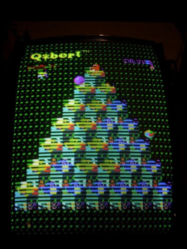

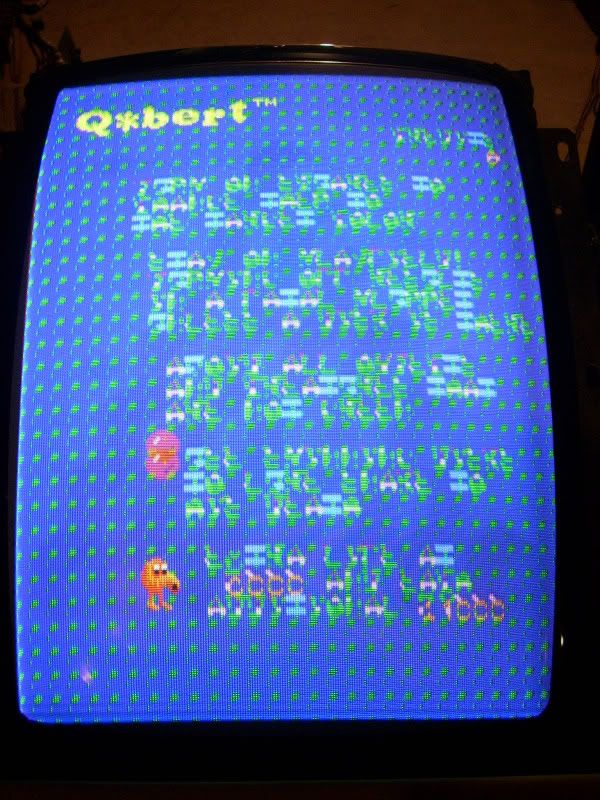

Ok so now that my Q*Bert is back together again I need to try and do a few repairs to the board. The first thing I did was make sure the +5 was okay and it's 5.02 measured across a TTL chip on the board. Looks like I'm having a problem with the main board. I guess the first thing I'll ask is should jumper jp12 be jumped or not? I ask because with it jumped the text is legible and the game looks more normal so it would seem that's the case, but I read jp12 isn't supposed to be. Here's a few pics of the background graphics issue....first with jp12 not jumped and then with it jumped. I have brand new mostek ram chips are new, sockets were metered and had continuity and each leg, and finally I verified the background roms were good compared to the MAME set. I'm not sure if the sockets could still be an issue even with continuity checks passing. Any thoughts on this issue? If it comes down to checking the 7400 TTL chips I have a logic probe, but would really appreciate advice on what to look for. Thanks everyone. I know Q*Bert questions get asked often.

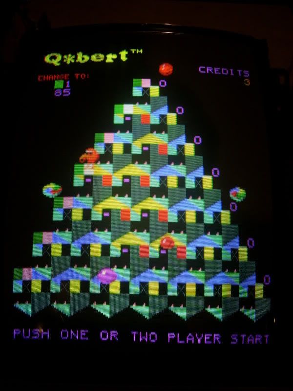

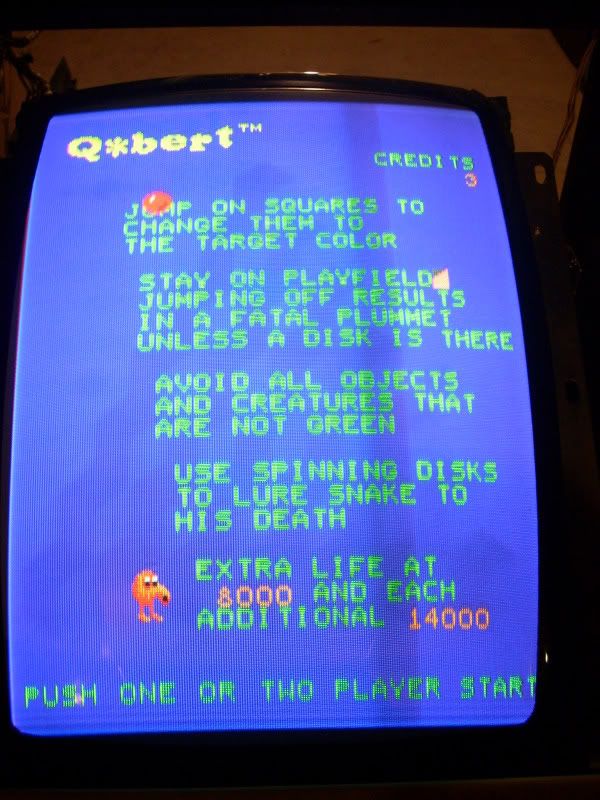

Here's 2 screens with JP12 jumped. I will note the 0's on the far right cubes change to 1's as you jump on them....maybe a clue?
Now the same basic screens without JP12...you can see it looks much worse, but from what I read, I thought it wasn't supposed to be jumped.

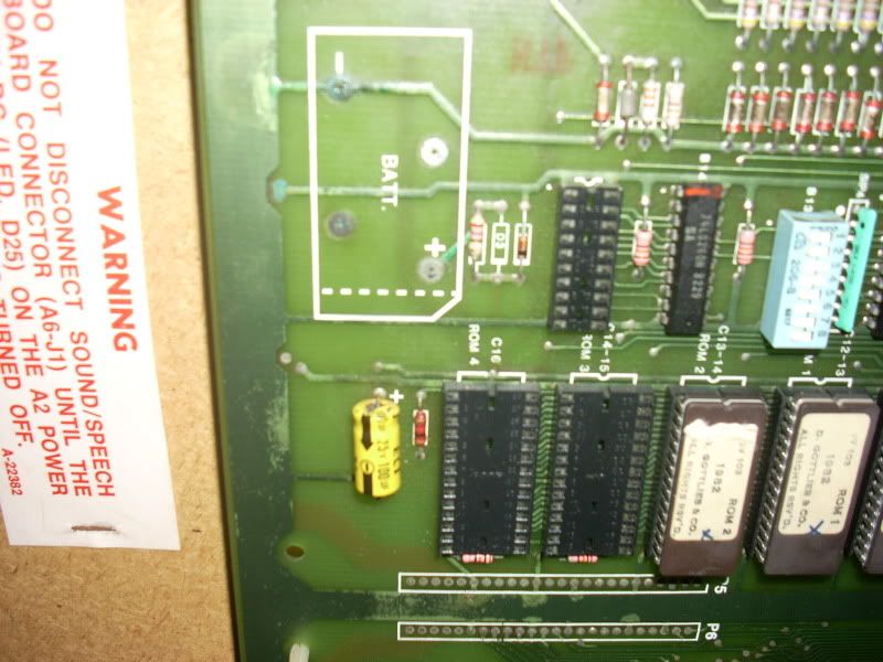

Any acid damage on that board?
Some yeah. Wouldn't you know the thing still had the battery attached when it was given to me...an old buddy of mine gave it to me and had sprayed wd40 on it for some reason. I can only assume it was an attempt to stop corrosion. It's not severe at least but I have wondered what factor could be playing. I haven't seen anything that jumped out at me as an obvious problem.
Pull rom 0-3 and check for corrosion in the sockets. Depending on how bad it is the corrosion usually runs all the way down rows 16 & 17. Post a close up pic of the top left corner of the board so we can see how bad it is.

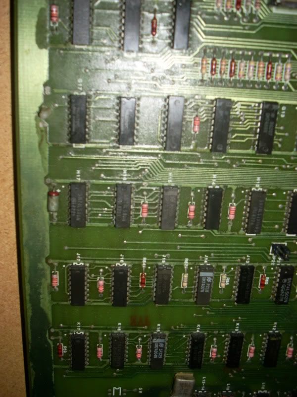

Thanks again for the reply, Riptor. I'll take a look at those rom 0-3 sockets later on today. Here's a a few pics from the left side of the board. You can see it's definitely had some acid corrosion. Hopefully this thing isn't so bad I'm better off just replacing it.
Thats not too bad, I have seen much worse still working perfectly. Also, correction on what I said. I should have said roms 0-2...three roms starting with #0.
