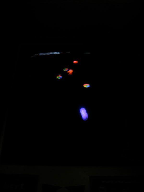

I'm stuck on fixing the jumbled background on my Qbert. Game plays find otherwise (except sound). Here's what I have done.
-Rebuilt power supply. I'm getting all correct voltages.
-Reflowed solder to filter board.
-Took out Clay Cowgill's Multi Qbert. I thought this might fix it with a new set of background roms. It still has a jumbled background.
-Cleaned, swapped and reseated srams e7 and e10-11. No change.
-As a test, I moved jumper Jp21 to Jp22. Background completely disappeared and foreground looked fine. See pics below.
Anything else to check? Thanks!
Jumbled background
Jumper moved from Jp21 to Jp22

74LS is not ram, they are TTL logic chips. Your problem could be low voltage, bad/dirty connections at sockets, bad ram, lots of things.
Its normal for the pyramid to dissapear when those jumpers are changed. You shouldnt be messing with the jumpers on the board. Post a good clear picture of your board so I can see if you are missing any jumpers or if maybe some are in the wrong place.

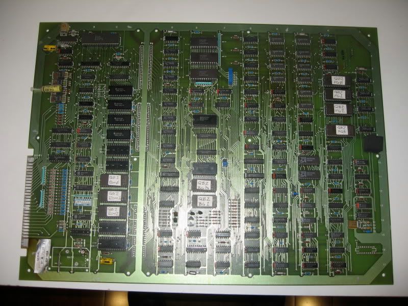

Thanks for the reply Riptor.
Below is a pic of my board. You can see hi-res pics here.
http://bpulliam.smugmug.com/gallery/9321739_6J2Wx/1/623293795_Mb3Ue#623293051_oMQun
Click on any pic on the right side and select the res size.
I checked the voltage on the board and I'm getting 4.9v on the 74ls logic chips. I'm getting 5.1v at the power supply. I cleaned the legs on the background roms, e10-11 and e7. Also checked continutity from the legs to the back of the board and they are all good. Wondering if I should still replace the sockets. Is there other socketed ram that could affect this problem?
Thanks again.
The 4 chips in Row C 5-8 are also ram chips. I have seen this screen appear when you have a bad ram chip in E10-11. I think its a 4801 type RAM. As Riptor said I have also seen this happen when the voltage to the logic board is low, but you seem to have checked that already.
Luke

I swapped out e10-11 ram with my Mad Planets so I don't think it's the chip. Maybe the socket? I'll try cleaning the row c 5-8 rams. Thanks.
Is it possible it could be a logic chip?
