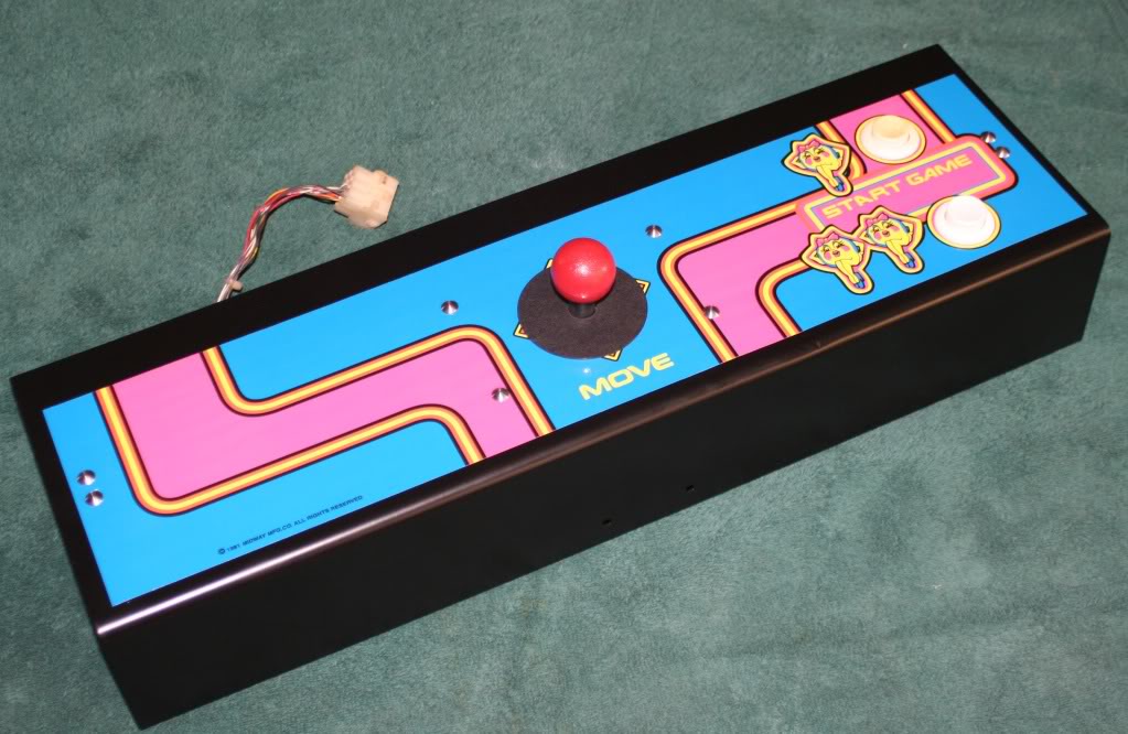

Since I'm still waiting on the bezel for this cab, I figured I'd turn my attention to the control panel. I've already stripped the CP and had it powdercoated black, so that's already done.

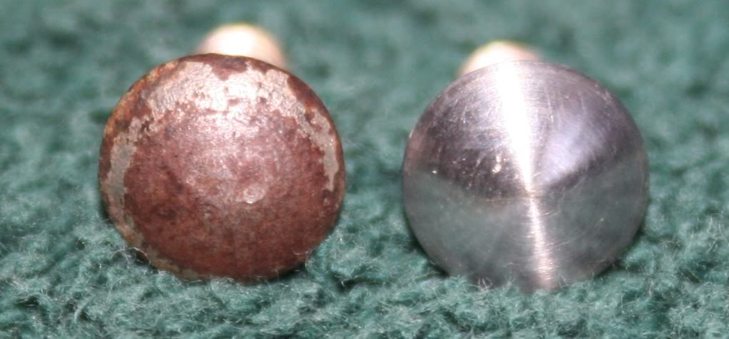

The CP bolts, however were in really nasty shape. They're a pretty small size for carriage screws. Not readily available hardware at my local Ace, which usually has EVERYTHING I need. I decided to clean them up instead of put something else in there. At first I tried my water + aluminum foil trick, but that wasn't getting me fast enough results, so I decided to cut down the top layer using a power drill and sandpaper. I followed the same procedure I did for my coin door bolts here.
Here's a before and after shot of my control panel bolts:
After getting those all cleaned up, I went ahead and replaced the centering grommet in my joystick, and wired everything back up:
More to follow later.....
Finished up work on the control panel today. This will NOT be my final panel, since there are a few dimples in it. I'm trying to source another dent-free panel. But for the time being, it will have to do.
CPO and hardware applied. Things are starting to come together now.
