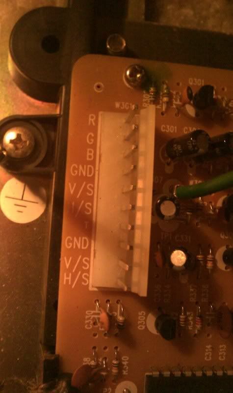

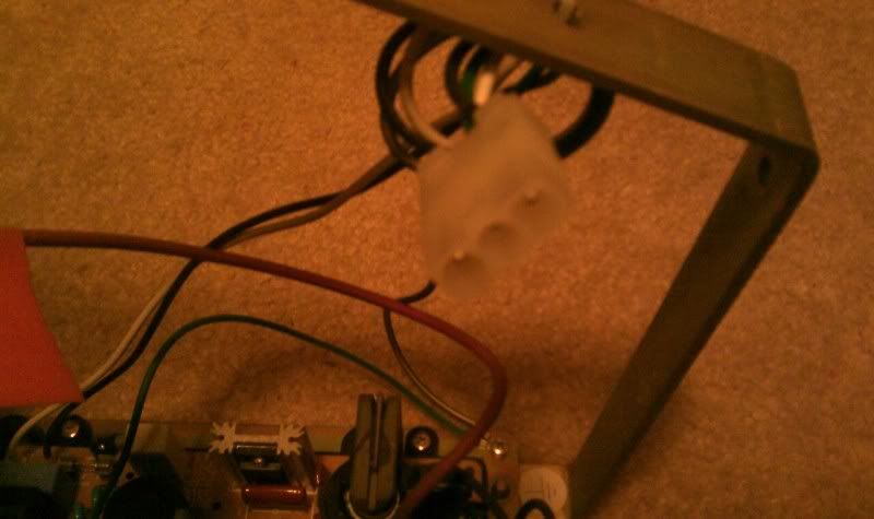

Hey guys, just snagged a never before used 7302 in hopes of replacing my bad electrohome monitor for my galaga 3, (this will be my first monitor swap) and the connectors are completely different. Do I need to get ahold of some adapter cords, or what? Thanks in advance for your help! -Jason
What's different? If I remember correctly, only the power connector would be different, and you can adapt that fairly easily with a new Molex housing to match what's in the cab...
I know the power is. let's see pics of your connectors from your cab, and where they should be connected on your monitor...
Power
Video from PCB
Video input on monitor
Looks standard to me. The larger connector is for your video colors and the 3 pin connector goes to your sync connector.
