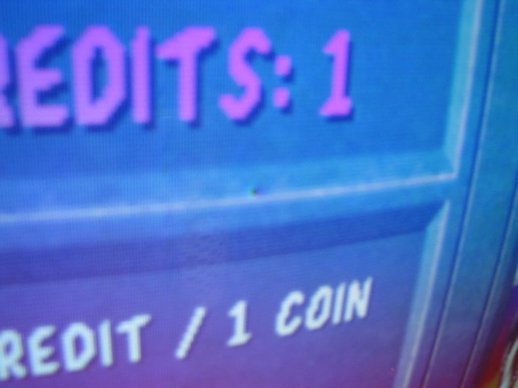

I have a monitor that's on a 4900 frame, but a Sharp Image chassis was installed on it at some point in its life. The SI chassis was poorly screwed in there with 2 diff types of screws. I got it working, but the arcade monitor tube has noticeable burn and there's a weird spot (like burnt or missing pixels) on the screen and the color shifts weird. (pic below)

Thanks for any advice. Pic of 'spot' on burnt tube below:
