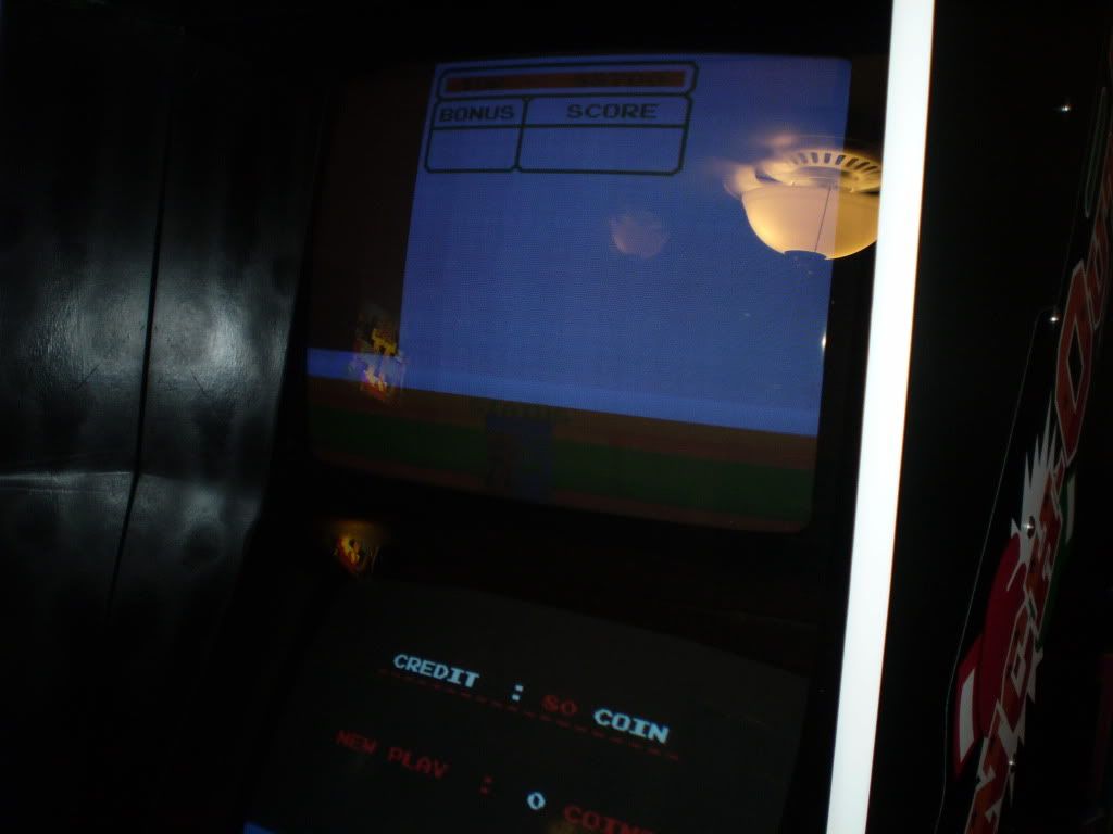

Have a pcb that is having the wrong image/colors show up.
Anyone have ideas?
Are you using the filter board? if so remove it and just hook the wiring directly to the PCB.
I had a Punch Out where there was no red on the top screen. Spent hours working on and checking the color roms. Turned out to be a bad filter board.
Try that and see if it helps any.
