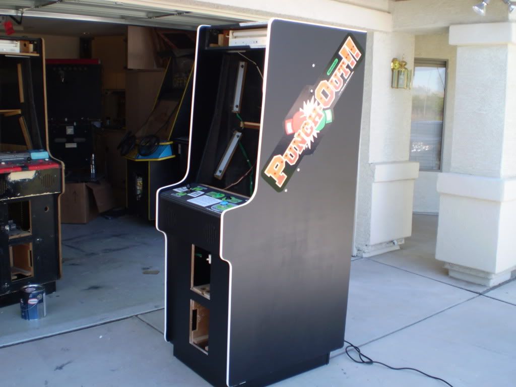

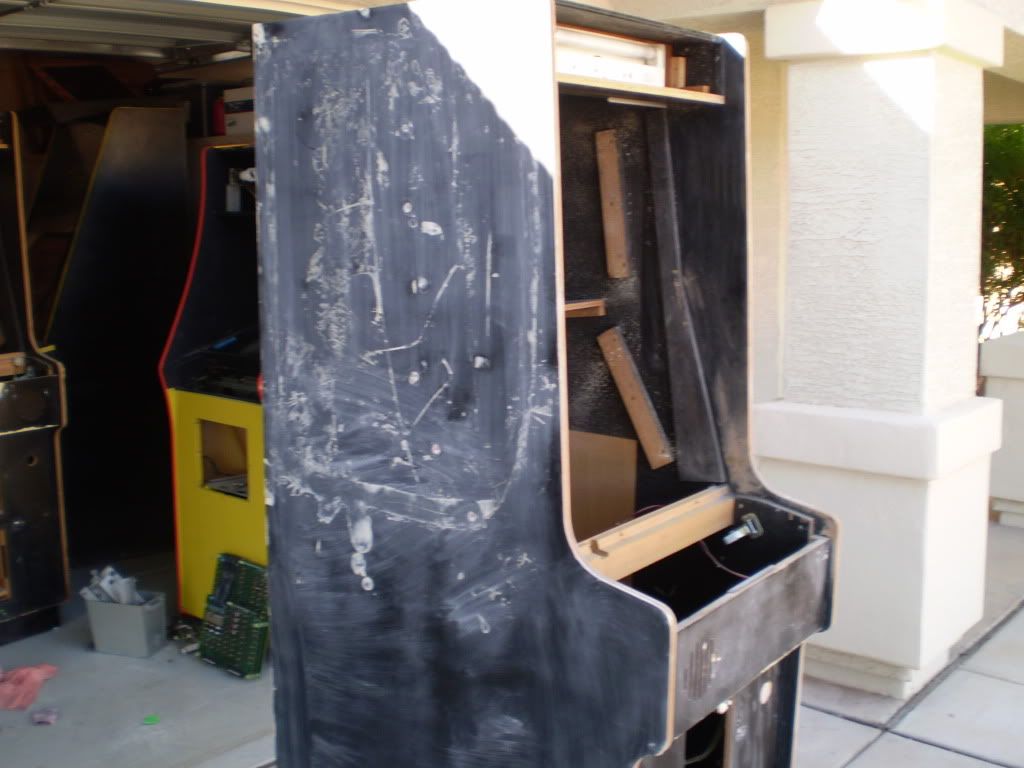

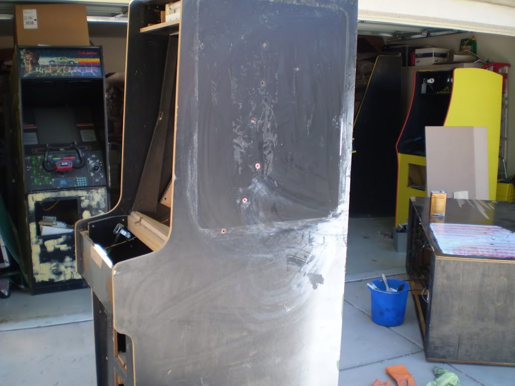

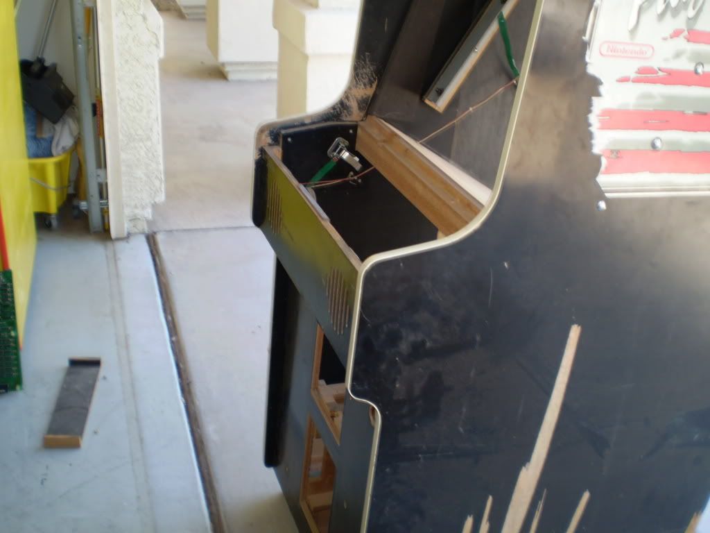

I picked up 2 Playchoice 10 cabs off of ebay. They were in Blythe, CA. Picked them up on my way back from Vegas (picked up a Pacman with a 96/1 from Brentradio, thanks again!) These are in the best of shape...you can see the first pic is from the ad, second in the garage.

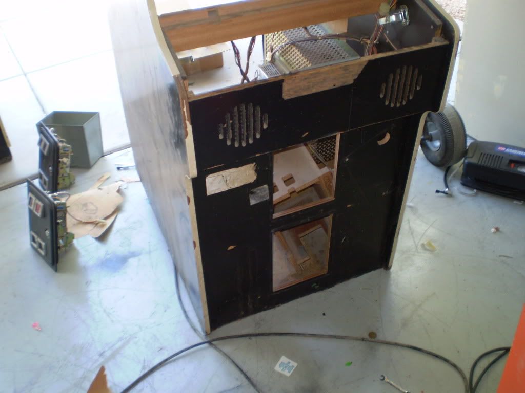

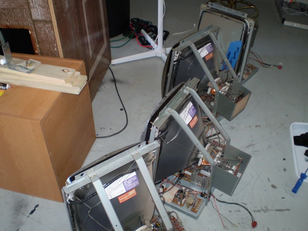

Pulled all the monitors, 3 work, need capping, 4th one has no power.
And the disassembly starts!

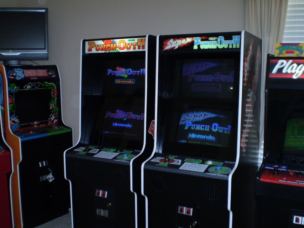

No, already have the Super done...this will be the little brother! ;)
Still working on the Monitors and Powdercoating. Should be completed by Wednesday.

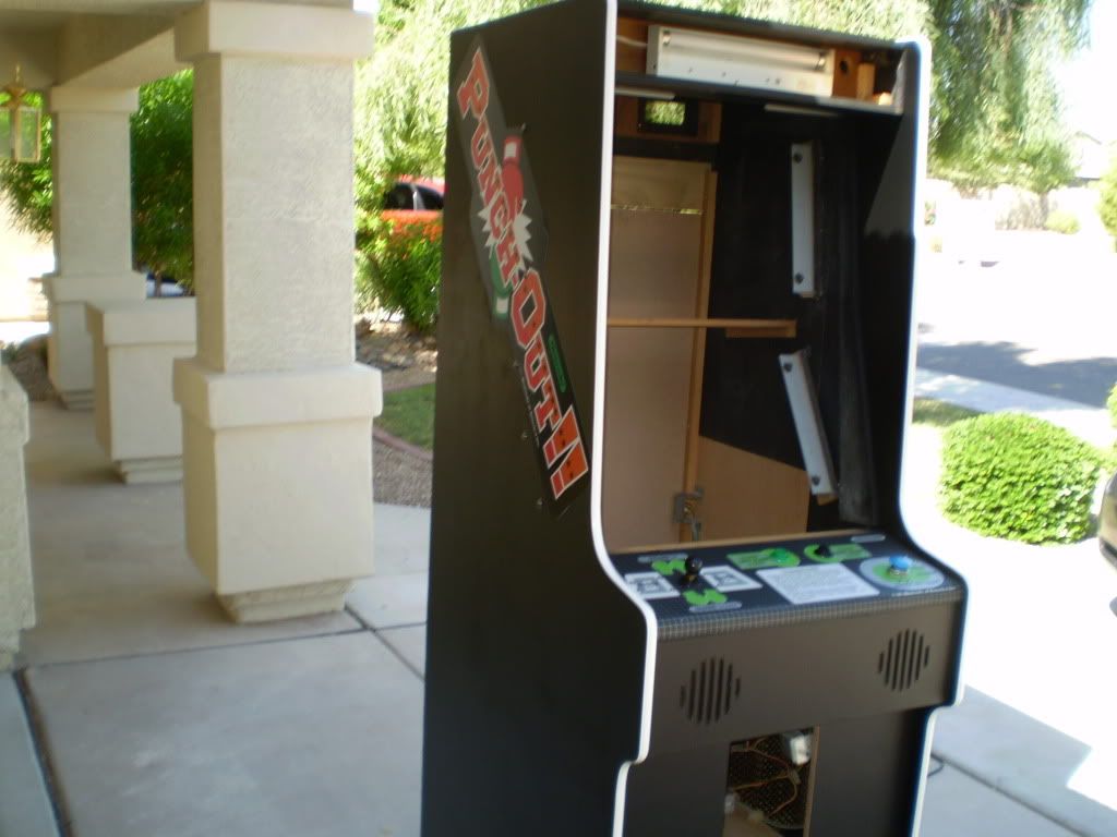

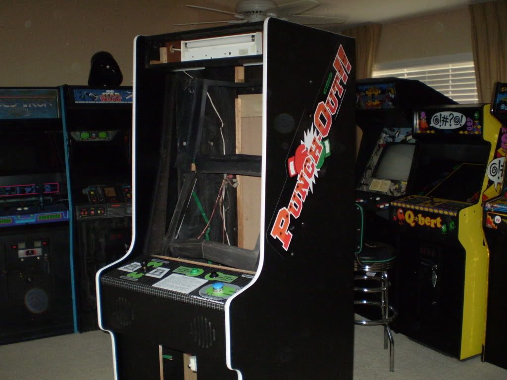

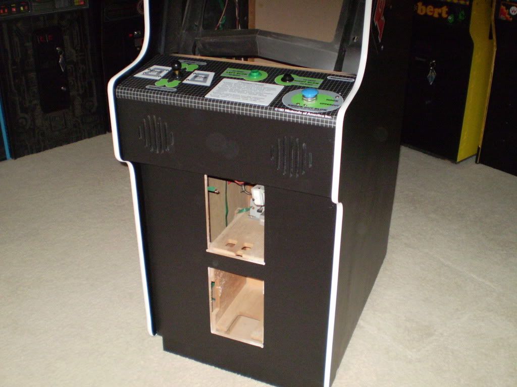

Well, after 10 days, it's done.
Only capped the 2 monitors that went into this one, still have the other 2 to do. Powder Coating was finished up today, so I decided to install it and snap a few photos.
I just lined it up in it's new home -
I still love the before pic -

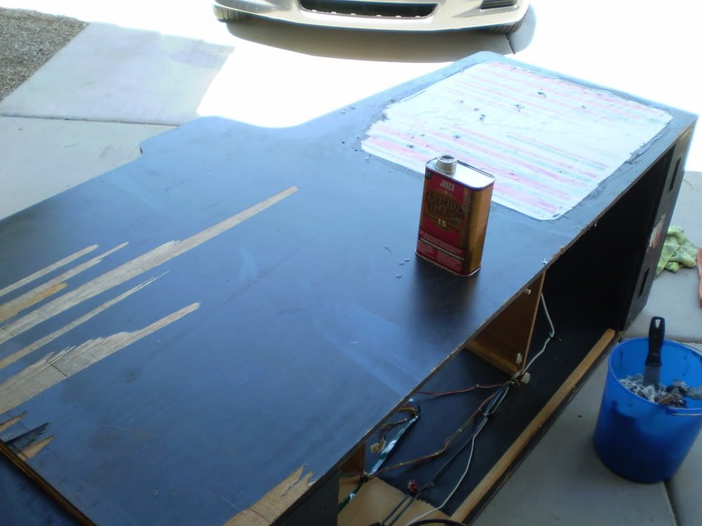

very nice... was that bondo?
what did you spray it with?
Yes. Bondo. Plugged the holes and filled. I didn't spray. I use a fine nap roller on the cab itself, and rattle can the inside. Just takes time not to get the rollermarks. I keep it light and do about 3-6 coats.

So, am I correct in thinking the other cab you aquired is going to be an Arm Wrestling?
Arm Wrestling was the plan, cannot find the parts or arts! ;)
Looks like I am going to do a dual screen Playchoice. I have the parts for that...
Wow. Done in 10 days. I feel like such a slug. My restores all take so long. Maybe I should fly you in so you can finish mine up! ;)
They both look really great, by-the-way. With 6 coats in 10 days...how long do you wait between coats? And, I assume oil-based paint?
Sorry, I'm not to be pimped out. ;)
Thanks for the props. Yes, oil. 18-24 hours between coats. I ended up recapping the monitors, cleaning and prepping the inside (during the primer) and other misc. things like the CP. Time management my friend! Plus it helps that I don't sleep too much. Why do you think I have 30 keepers? :)
