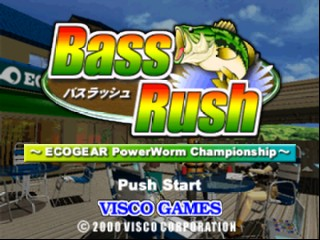

When Bass Rush came our for dreamcast a long time ago I thought it was a music bass game of some kind. A few friends still won't let that one go.
