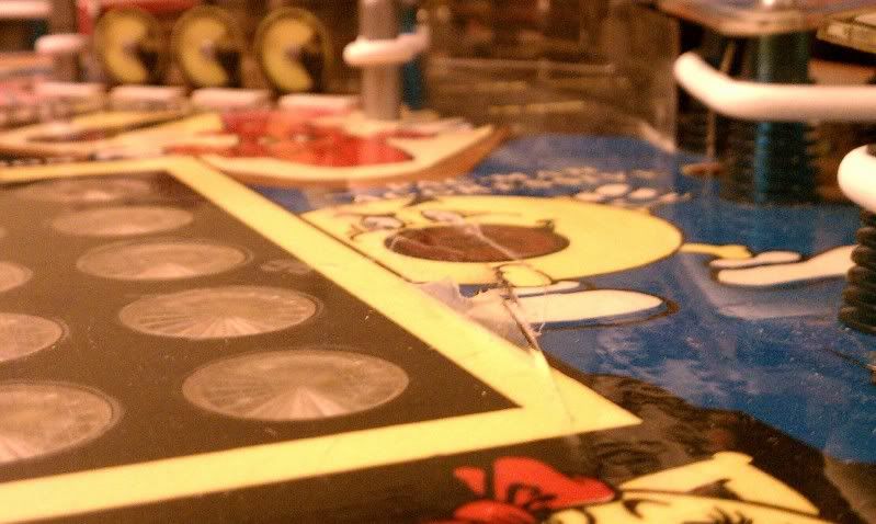

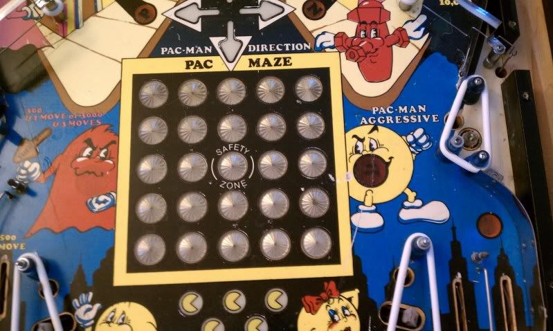

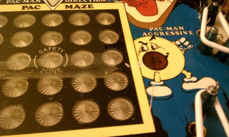

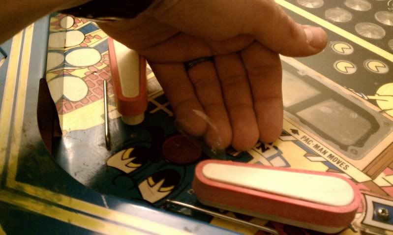

I finished pulling the mylar off of my Mr and Mrs Pacman today. Used goo gone. Seems like it was put on by an operator, not from the factory, it came off too easy. Very minimal paint lifting as you can see from pics. I just have to get the glue residue up, but I'm happy with the results. I had to take it off because a previous owner tried to take it off, and cut part of it with a razor, they f'd up a little of the playfield, but not too bad. First pic is showing it originally. then it shows the removal.
And the paint lifting result. Not too bad.

Used freeze spray / canned air and it came up pretty easy. The only lifted paint was from around the area the mylar was bubbled.
It wasn't rectangular, so it probably, like you said, came with the pin. As far as how i did it, i got goo gone in a big spray bottle, I dribbled a little bit along the edges of where I started. I let it sit for about 5 minutes, then I started pulling it up. I very slowly pulled as evenly and as slow as possible, stopping every couple of cm's to wipe up excess and dribble a little more along the pulling edge. It cam up in one peice, and I found the areas around the lights ended up being a little start for paint pull ups. Now there is just glue residue left, it seems to up easy, even a little bit of rubbing will ball up the glue. I think its just goingng to take a little albow grease.
