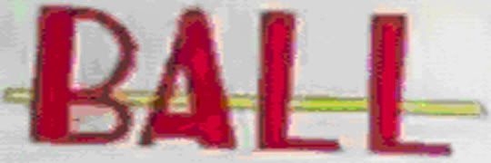

ok i need the font ? or can somone help out with this ....
the letters are 2.5 tall and 7.5 long ( from start of yellow to end of yellow )
Thanks
David
