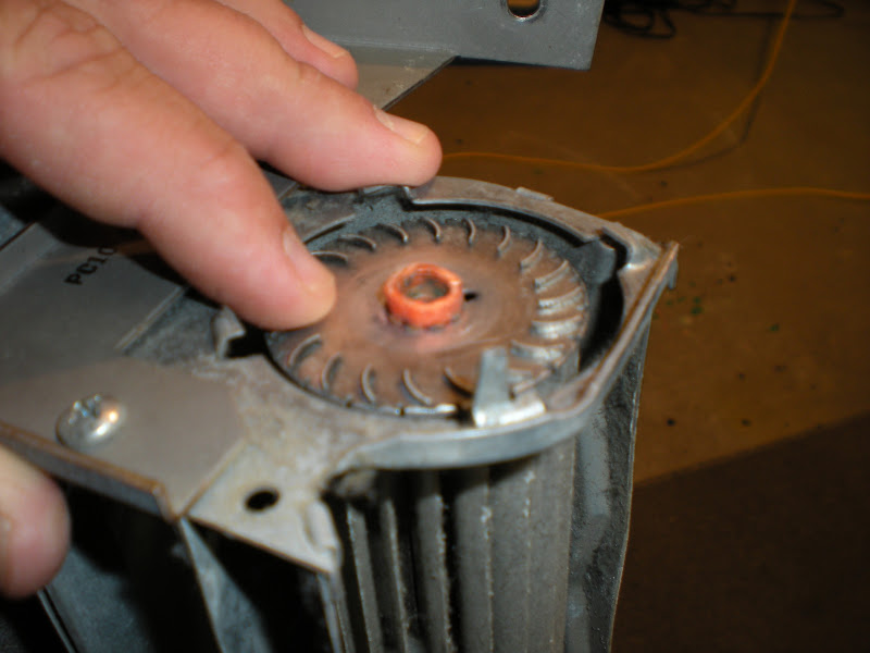

Pulled the fan apart and found the problem
The way the fan mounts is completly retarded, I cannot imagine that any propcycle fans lasts too long.
Check this out:
This is the upper fan, the hole that the rubber (I don't even know what to call the part) fits into is all torn up!
This takes the cake, some apple genius :) tried to fix the lower fan by shoving a twist-on wire connector into the whole! I spins, but doesn't get ANY traction, so it barely blows.

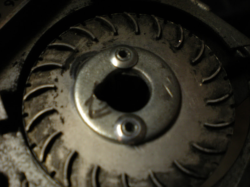

I fixed it using a washer that i notched and riveted it in place:
It works, but I wasn't perfectly on center, so it wobbles. What I need to do is run a shaft right down the middle like it should have been done from the factory. I haven't figured out how I will connect it to the motor yet, probally with a shaft collar or something similar.

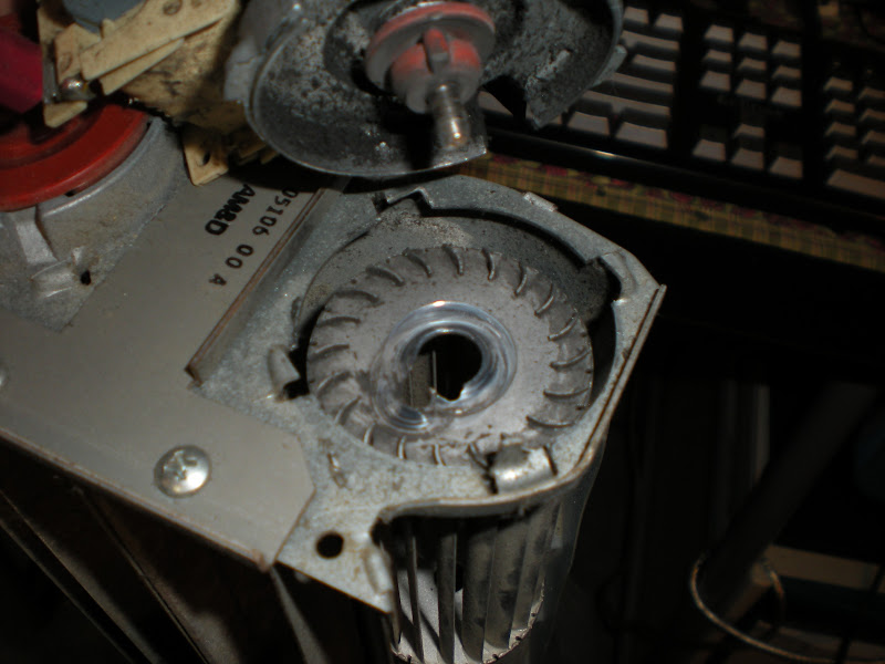

All fixed!
I might have a fan/motor for that. Give me a measurment of the squirrel cage. What voltage motor is it?
I have a couple I got from a friend who did HVAC a while back.
Thanks Riptor! I was able to fix it with the help of my father's CNC machine. He made a replacement for the rubber part out of aluminium, it works so much better now!
It is better than it was new!
