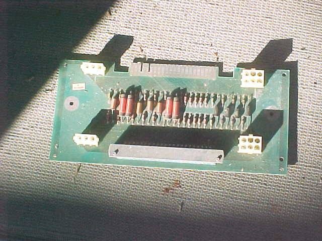

Looks good... The plug you found looks like it goes to the filter pcb that has been removed..
On the monitor start by checking the 2 fuses on the monitor chassis...
If i go back to original PS will I need to grab another filter PCB if its been removed?
