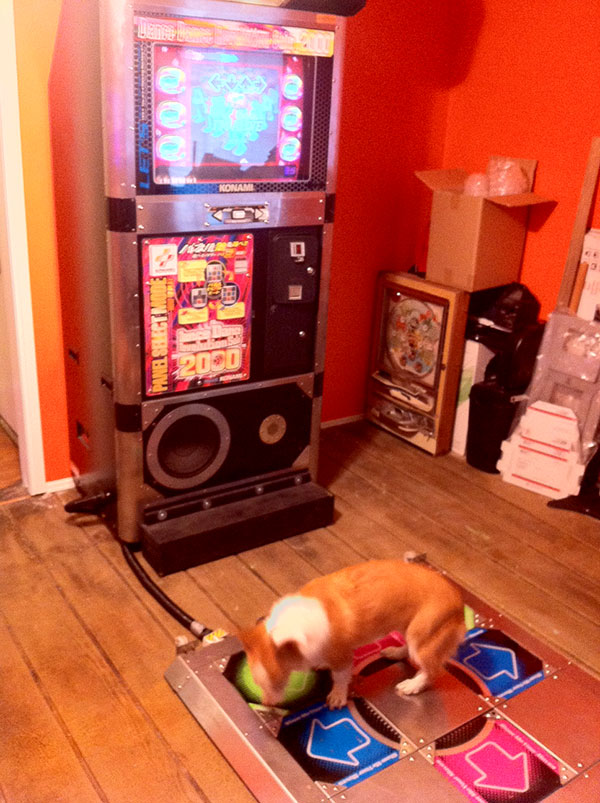

Looks like I'm going to get the DDR Solo. First step is to give it some time and vet everything hardware-wise, play the hell out of the stock mix songs, and then start looking at upgrade options, whether I want to run a newer mix (and find sources for the upgrade discs) or whether I want to convert the machine.
Thanks for the advice all, here's what ended up in the (in progress) game room today:
