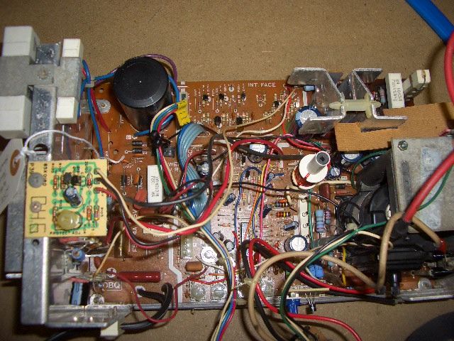

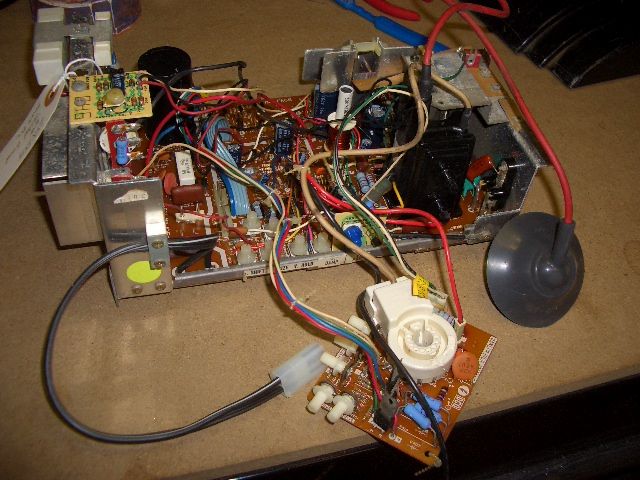

I just removed and replaced solder all over this chassis and neck board, cleaned up the chassis a bit, replaced the missing AC connector. This has not had any other components replaced. I tested this in my Hard Drivin cockpit, dialed in the colors, adjusted the focus and brightness. Great looking pic, but I cannot get the image to fill the whole screen, looks about the size of a 19" monitor, on a 25" tube. The fly back seems strong, very low settings for the focus and screen brightness.
I haven't really found any good information, to base a price off of, for a working chassis. I know there are some Atari collectors who could use this :)

What do I need to look for to tell the difference? I didn't realize that 19k4915's looked the exact same, never needed to know what one of those looked like yet. Searching now............
OK, from a quick search, I'm seeing two visual differences between the 25k5515 & 19k4915 chassis: the 19k4915 uses STR380 VR, the 25k5515 uses STR381 VR. Looks like the 19k4915 chassis, has a metal plate that attaches to the top of the flyback, from the chassis wall. Can someone verify that this is accurate please?
