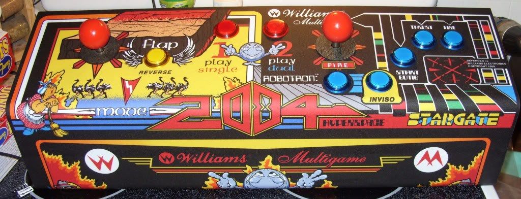

I have (micros), and just installed some buttons (micros). 3/4" to bottom of red balls from the top of the panel. This one is not my keeper panel, but one to go on a cab to sell. I am going to use leaf switches on mine.
5/8" wood block spacers with chuncks cut out for two of the buttons on the right joystick.
two 5/16" washers per joystick stand off so that the dust cap can sit between the metal CP and the wood spacer.
attachment.php
attachment.php
I like how you did this.
The joysticks standoffs should have been bolts instead. This way you can mount it without a wood spacer for 3.5" joysticks. This current way gives you less options.
After looking at how you did it I was trying to figure out a way that I could mount the smaller joysticks so you would still get the distance above the panel as the 4" shafts.
I was thinking that you could just enlarge the holes on the joystick base so it would slide down the mounts. you could then use spacers above and below to set your your shaft distance to match that of a 4" shaft. Make sense?
I may have to try that on my next one. The first one I just built for a cab that I am planning on selling.
You are right about the bolts, that would have been perfect.
Yeah I get what you are saying but the simple solution would have been to make the standoffs as bolts. NOTE FOR FUTURE RUNS OF THIS PRODUCT. You shouldn't have to drillout the joystick holes to clear the stand offs. That would ruin the joystick from being used on any other project.
Don't get me wrong, I love my CP. It's well made and everything was like spot on exact.
Does anyone know what goes between the CP and the glass bezel? My wood CP mated up right up to it. I was thinking to go to HD today to get some black rubber sealant and put a strip of it right there. Steel on glass is fail.
I get that the standoffs were made so that this could fit 4" robotron sticks but if it's lower then 3.5" sticks would be also fit perfect and the dust cap would free float in the gap clearance provided by the joystick body.

Couple questions as I have never seen a joust/robotron cp before.
I assume the three sets of 2 threads on the left edge, right edge and middle
are for some sort of clamps? Where can I find the appropriate parts to put on
here and to mount to the cabinet?
What is the are the 2 lone threads in the middle of the panel for? Ground?
What are the five holes on the bottom for? A hinge? Where can I get one of these?
I have a couple 4" robotron joysticks. Why are they mounted so far away
from the panel? Is this how they are supposed to be?

The panels are metal, original panels are wood, the joysticks are mounted like that to simulate the thickness of the wood.
Everything else you need should come off the cabinet your using. So just use joust control panel hinge and clamps. If your missing that stuff try arcadeshop.com
