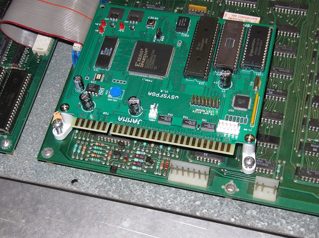

The ONLY gripe that I have about it was the means of mounting the board in the cabinet. The supplied standoffs and screws simply will not work with the original mounting points, and if you try to use the original mounting bolts, they are both too big to go through the holes on the new board and too short to be used with the supplied standoffs. The ONLY solution that I could come up with was to use the supplied standoff and screws to mount the board directly to the back door ABOVE the original metal panel. This caused the wiring harness to stick up a little too high to allow you to close the lower (swinging) back door panel, but after bending the wires in the harness down, it will clear the separator brace that runs across just above the door. This is a MINOR gripe, but I figured that it might help out others in the future to know what to look for...

Hey Lee,
The mounting holes on the board aren't the correct size or spaced to fit the original mounting points on the metal sheet. You have to use the standoff feet, to mount.
You might want to try just a slightly longer screw with the original mounting points, or just cut down the top of the foot, as they are kind thick. It wouldn't need much until it bites on the original mounting.
Here's how I've mounted it. There was just enough thread with the original screws to grip the mounting points, granted there wasn't much tolerance there ;) Although if you shave a little off the bottom of the standoffs they'll definitely fit. These are shots of how I've mounted the board on an original plate, IIRC arcadenut mounted his with the original boards still in place in the cab, I think we had to reduce the foot depth.
EDIT:
It appears from looking at the screws.... there are two different types on the WMS boards I could find. One has a narrower thread at the end and the other has a very flat end. These flatter end ones will literally just fit into the metal plate with the thick standoffs. The other ones won't bite and will have to adjust the stand off.
Neither of this length, 1/2" will fit with the PCB in place, they'll need a longer screw or adjust the standoff.
Mounting pics with #6 3/4 screw for best results
