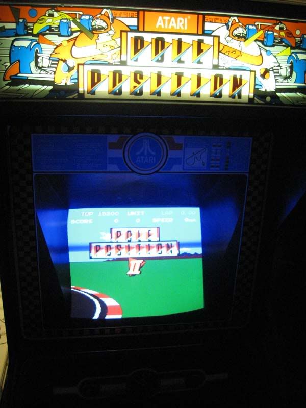

I picked up a PPII PCB set that I was told was fortified by Dick M...I simply added a 4-pin MOLEX and wired +5 and GND from a switcher directly though all 5+ and GND test points on both the CPU and Video boards. I then copied the power hacks that Dick had done to the PPII board on the PPI board. Both boards now fire up every time... I, of course, removed the +5 lines from the harness...
This is the PP1 board... the PP2 is currently in the cab...
TO DO: Fix that damn cardboard bezel on the left...it bugs me.
Oh, and that is the $160 delivered 8-liners monitor you see in the photos.
