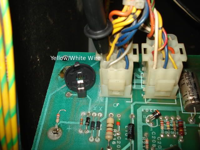

I have a spy hunter and a tron id like to start trouble shooting(i belive they are the same PS board). i guess the first step is the power supply? can someone explain in detail how to test these boards to a newbi. i have removed the on board batteries. cleaned them up. also from the goggleing i have been doing what does "MCR" stand for and why is there a I II III. just trying to better understand these games...

The best way to test the board would be to find out which board you have. I only work with MCR II stuffs for now, so I don't really know if there is a huge (if any) difference in the PS used for the different systems. I know that MCR I boards seem to work just fine on my "MCR II" PS in my Tron. I used the Tron manual to test the power supply. I got my manual in PDF format from CrazyKong and the information you'll need to check the PS starts on page 96. Granted, some of the colors are wrong in the manual... best example would be that the manual says the +5 lines are Red... mine are actually Blue. But everything else in there is more or less right. That's for the PS board... as far and the boat anchor in the bottom of the cabinet... if that thing is broke, well... I guess it COULD be fixed... but thank God I've never had to check into it.

Here's a quick run down.
This is just what I do... there are probably better ways of doing it... and I'm sure someone will chime in with a better way, but this is what works for me.
First, with the machine turned off... I wedge my ground probe from my DMM (I call him Mr. Fluke) into the ground socket. I use the Yellow/White wire because, well... it's ground. You CAN use the Yellow/Black wires, but you're readings will be off by a few tenths of a volt... So why bother.

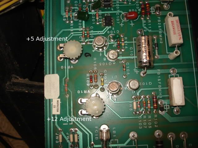

With that wedged in, I turn the machine on and then start to check the +5V lines, on my machine they're blue, according to the manual, they're supposed to be red. No idea... I didn't make the thing. You can see here they're a little low... I turned it down on purpose so I could show you how to adjust it... but I figured that would be self explanatory after the a few pictures down, so I decided to skip that.
I check each of the blue wires at the board... if you don't trust your PS, then don't plug the boards in, check it on the back of the board connector. Where each wire is attached to the connector, there will be a little area just below that which is bare metal... pretty much meant to be used for checking voltage.
After that, I check at the +12V line, It's orange on my machine, and orange according to the manual. But just in case, it's the connection pictured here.
You're going to want at least +5V and +12 on those lines. +5 on the blues, +12 on the orange. A little over doesn't hurt, but a lot over can. So... between 5 and 5.2'sh on the blues, and 12 and 12.2 on the orange...
Turning the potentiometers on the PS will adjust the +5 and +12. I do it while the machine is on, mainly because I'm dumb and a glutton for punishment... I'd recommend turning the machine off each time you do an adjustment. After you turn in a little, something in the neighborhood of 1/20 a revolution, check again and go from there.
And ignore that resistor in the first picture. That's the resistor that had to be replaced when I did the battery conversion... I didn't want to lose it or have to look it up again later if I decided to do anything else, so I just tacked it onto the board on an unused pad just to save it.
Don't test the PS w/ the board hooked up... if the voltages are bad, it'll blow the board... but chances are it's been powered up with as is already, and has already blown the board, so at this point it doesn't matter...
