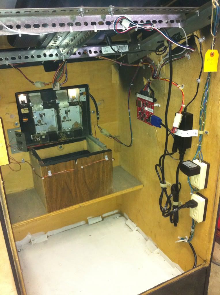

Well, I think I finished the most "green" machine ever.
Eco Arcade game!!

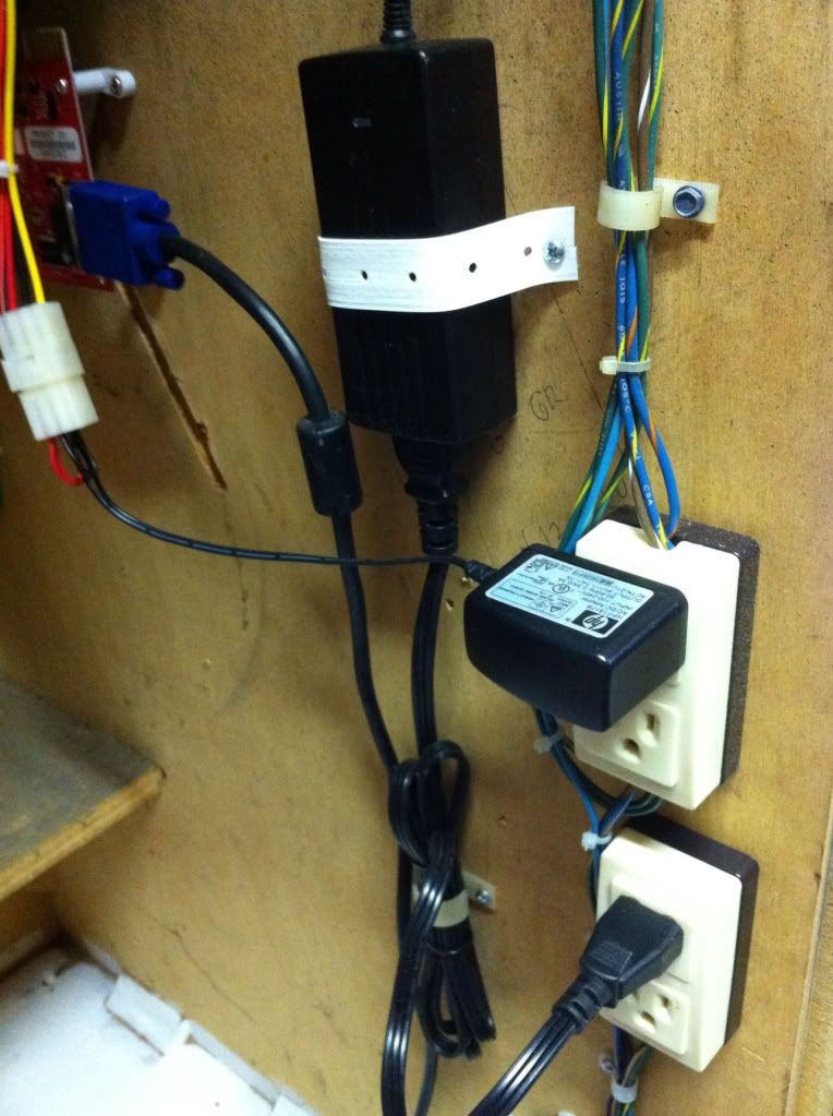

The arcadeSD draws so little power I used a PDA wall transformer to run it.
Now, while my preference isn't LCD, my friend wanted it, so That's what it is.
The custom mount was cheap and easy to make from strut available at Lowes.
The other issue the LCD fixes is that the Rally-X cabinet isn't deep enough for a vertical CRT.
LED bulbs in the coin door lights keeps power down too, also run off the PDA transformer (rated around 2amps for 5v)
