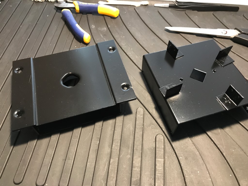

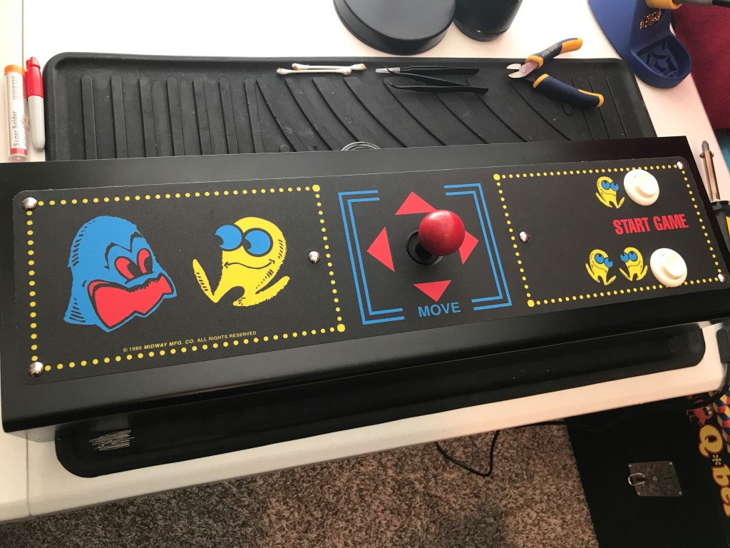

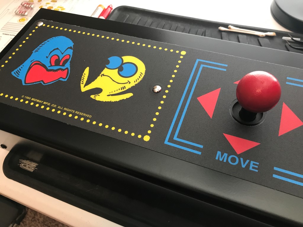

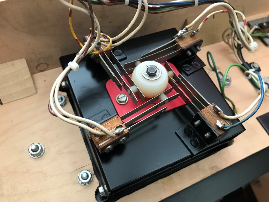

When I restored the control panel on my Pac-Man. I just used the Rust-Oleum Satin enamel. Striped the panel down to bare metal so it was nice and smooth. Then sprayed a grey primer. (not sure the primer was even necessary because I had to sand that smooth anyway) Then sprayed about 3 coats of the Satin black on there. (First couple of coats were pretty light)Also sprayed the metal portions of the joystick. CPO was from Phoenix Arcade BTW.
I was very happy with the results for how little I paid. Sure, I had to put in a little work but it's not like it was that bad. Again, not trying to talk you out of powder coating. Just giving you some food for thought. Restoration cost can really add up and this is definitely an area you can save a few bucks if you are so inclined.
