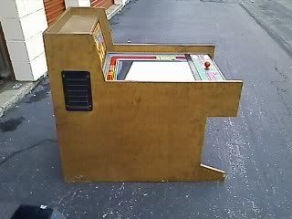

Hello all you smarties out there! I MIGHT HAVE JUST FOUND THE HOLY GRAIL OF ARCADE MACHINES!
I have something quite interesting on my hands; here are the pics to wet your whistle and further down I will explain how I got it and what little information I was told about it.. I will also post detailed pics inside and out, below-
My wife is in this pic just to show how big this thing is-

Am I the only one to notice that this:
Is different than this:
The first one has protruding legs.
It seems to me that this cabinet might have been designed to be wheelchair accessible?
Which reminds me that Phet wanted to make a wheelchair accessible cabinet.
Interesting piece.
Doesn't look like a lot of fun to play though.

Also, that cabinet looks a lot better than the other prototype. I mean if they really were prototypes they may have made all kinds of different treatments before they decided what they wanted to do. Or it may have been a thing like, they made these up and sent them home with people that worked there so they'd be small enough to transport, and they could beta test them at home or something. Pretty cool.
Interestingly, I think the cabinet screams 70's even though it's an 80's game. Perfect for your setup. Curious what something like that would be valued at though. Probably hard to put a value on.

Yeah, I noticed that too. It makes sense if these are indeed prototypes, they should have little differences.. Fortunately im liking that mine doesnt have those protrusions!
