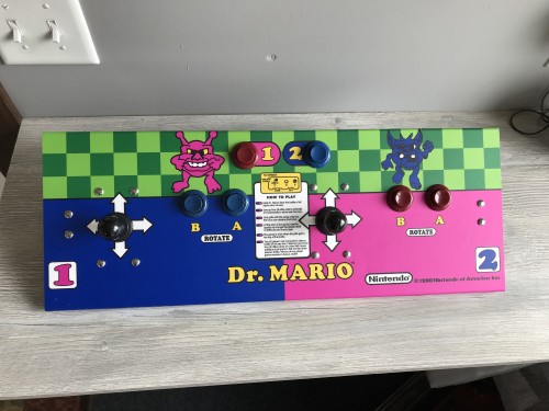

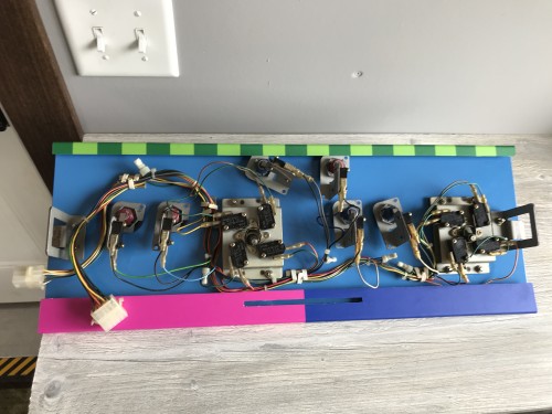

This was one of Rich's overlays he had sent me years ago as a gift. I had stored it away and all but forgotten about it. I then remembered having stripped and powdercoated a Vs. Panel blue several years back. I never really knew what to do with it, so I figured it would work perfectly for my Dr. Mario panel. Over the course of 2 or 3 days I located the buttons, switch holders, brackets, joysticks, bolts, wiring harness, etc and assembled it all together using an original Vs. Panel as a guide:

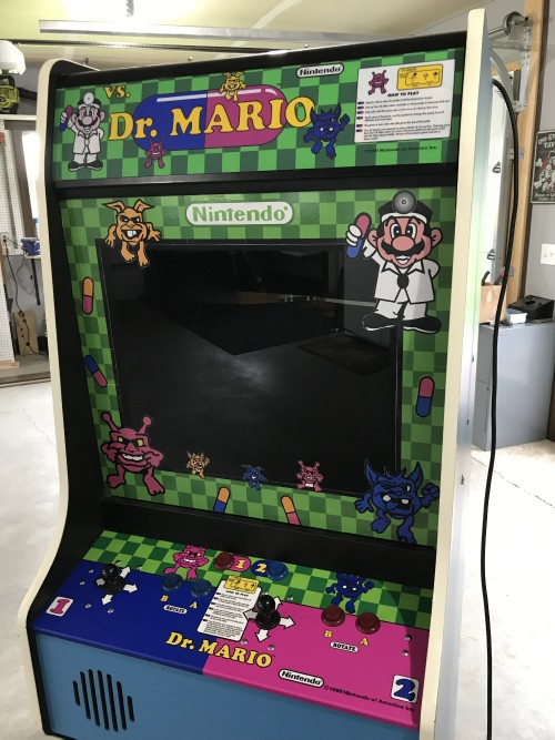

Next I went into my Bezel stash and found the original Dr. Mario bezel I had designed and made back in 2006 or so. Luckily it was still in great shape. I also located the original Dr. Mario trans light marquee that I had stashed in my artwork folder 10+ years ago. It too still looked great. I put them on the cab, and here's how they all look together:

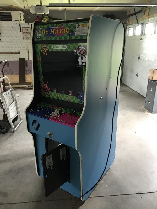

I then took a magic eraser to the cabinet and pretty much have the original blue finish looking perfect, other than the blown out corners.
I think rather than bondoing and painting and wasting another 2 months, I might just buy metal corner protectors for all four bottom corners, paint them DK blue (or T-molding white) and slap them on the cabinet. I am also going to get a set of the Dr. Mario side art from Rich and call it good from a cosmetic standpoint.

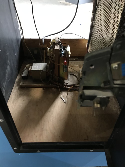

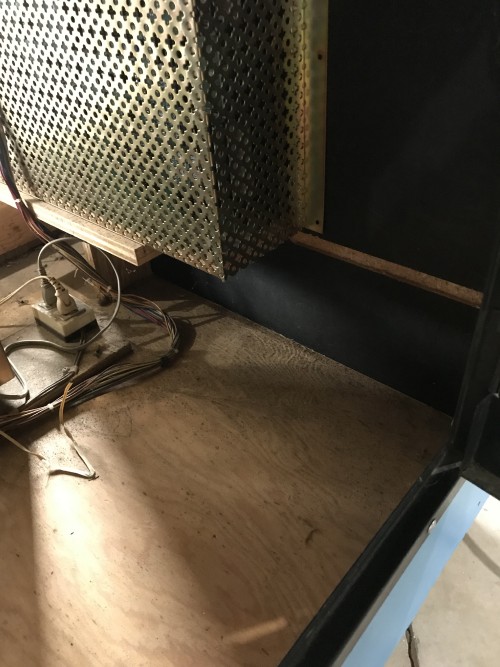

Next up is wiring the cabinet and building the coin box tower. That was another detail I missed before owning this machine. The tower had been completely ripped out by a previous owner for some reason:
I have built one of these towers before for a cabaret machine, so I figure it shouldn't be too hard, though I noticed that there are at least 2 different sized coin boxes between the cabaret and full sized machines, so I'll have to make some depth and width adjustments to my plans. I also realized that the particle board cabinet has a routed slot on each side for the tower to slip into, so I'll have to figure that out as well:
The plywood cabs just use blocking, screws or staples and glue.
That control panel overlay with your bezel looks really good. Daddy likey.
Yeah it does. To be perfectly honest, I didn't like the CPO when I first got it, as it was sooooo different from the CPO I had designed to go with my bezel. After sitting on it for a few years tho I really am starting to like it more and more. Kinda wish he woulda left the instruction panel off tho, as it is already on the marquee.
