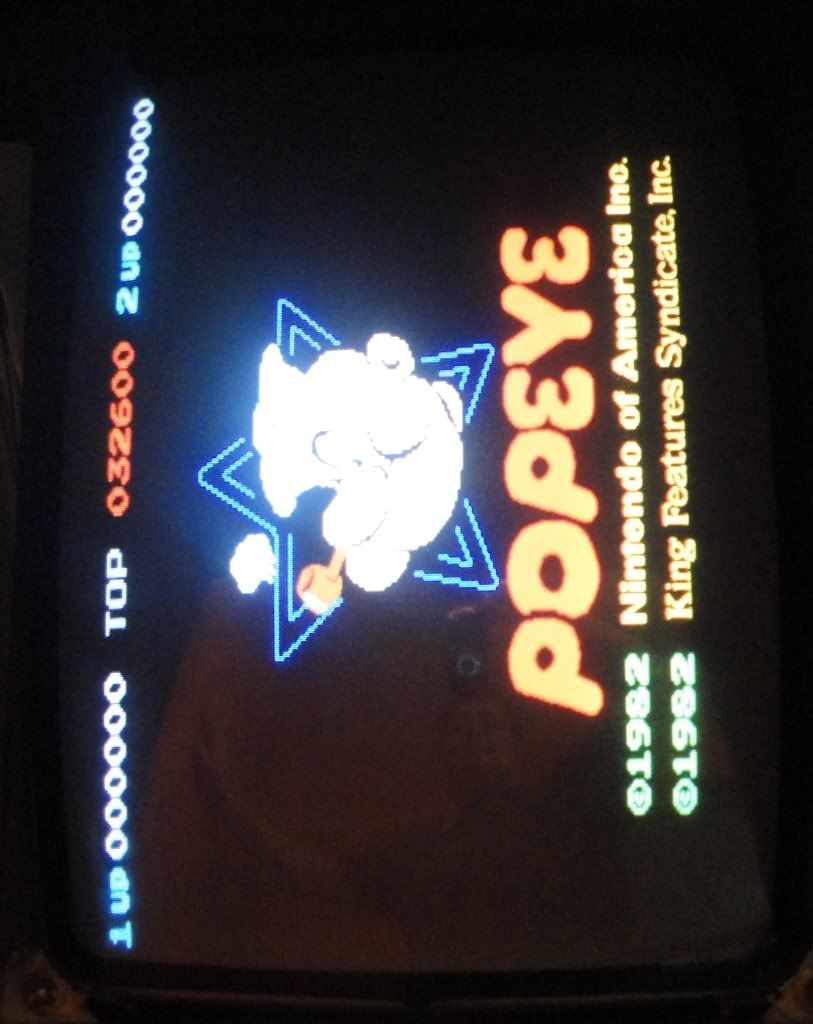

Tested a Popeye board today and got this...
Nothing wrong with the cab or monitor. It's a PCB issue. Anyone have any ideas???
Looks like bad video RAM or a horizontal counter problem. Are the RAMs socketed? If so, try swapping some and see if anything changes.
I had a Popeye board do the same thing. Reseating and cleaning the legs fixed her right up. Those things were built with some weak sockets.
