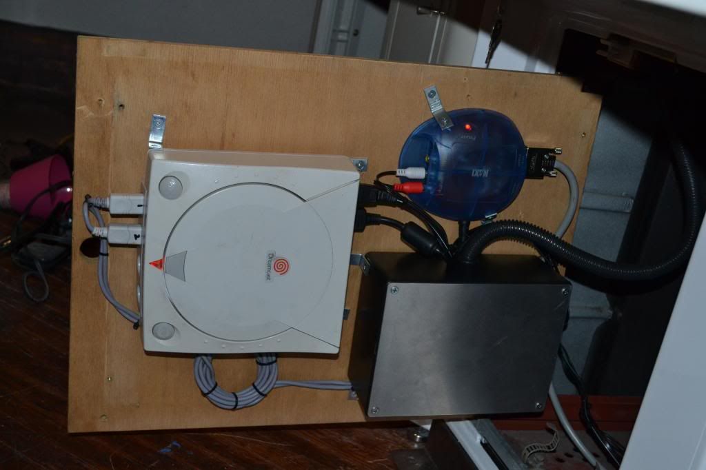

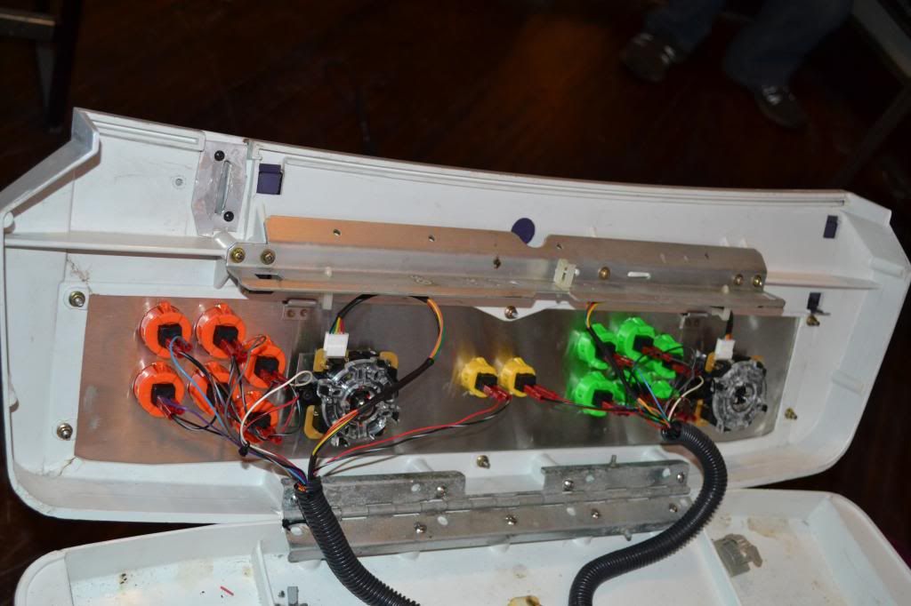

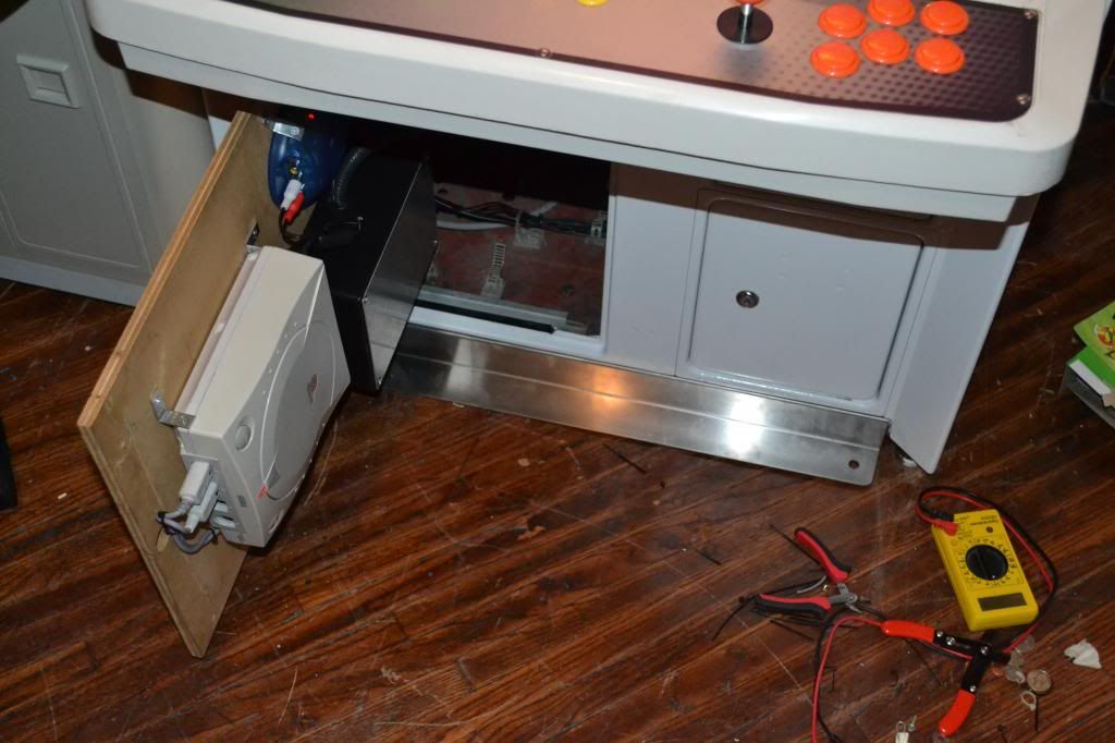

I am finally done with something ive been wanting to do for about 2 years now. I recently picked up a blast city fishing cab and converted to a dreamcast dedicated machine. The dreamcast plays damn near the same as arcade games and is a really nice system that outputs vga and I have it running on my wells tri res. Please let me know what you think. I tried to make this look as nice as possible and make the hardware look part of the machine. Ill be making a video soon

Hope this video explains every thing enough. The little
Pcb were I connected the audio is actually the the I/O board and I had a spare connector with audio wires on it and just soldered stereo outputs on it. I can A larger pic of needed
When I do this, I do a controller hack into a JAMMA finger board and IDE connector for the kick harness. Then I make sure that my controller and kick harness grounds match on the same side of the JAMMA harness. This way I can easily pull the console and swap the machine back to a JAMMA board in an instant.
I thought about doing it that away but I planne on keeping this setup in here
