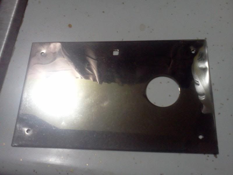

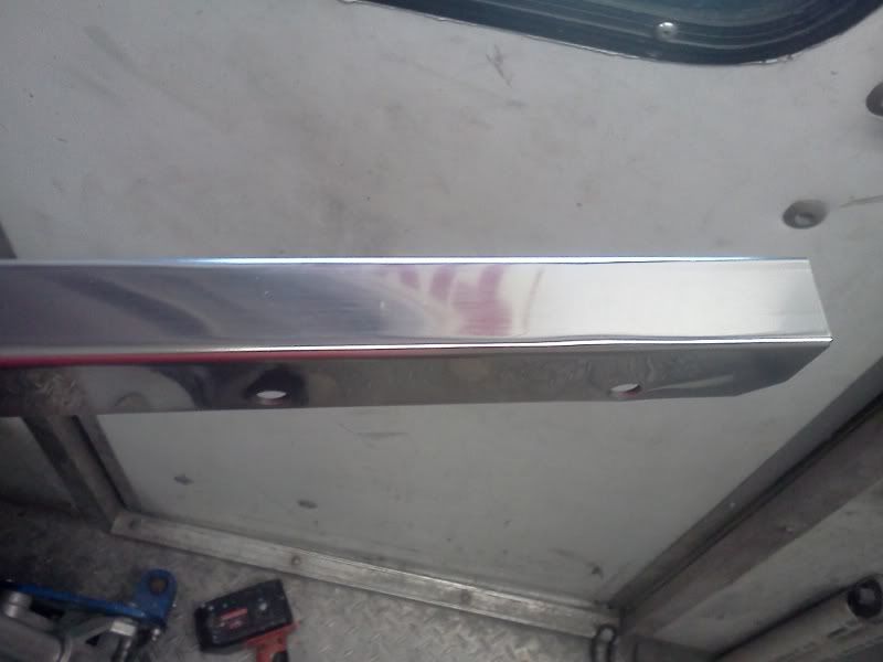

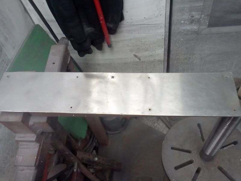

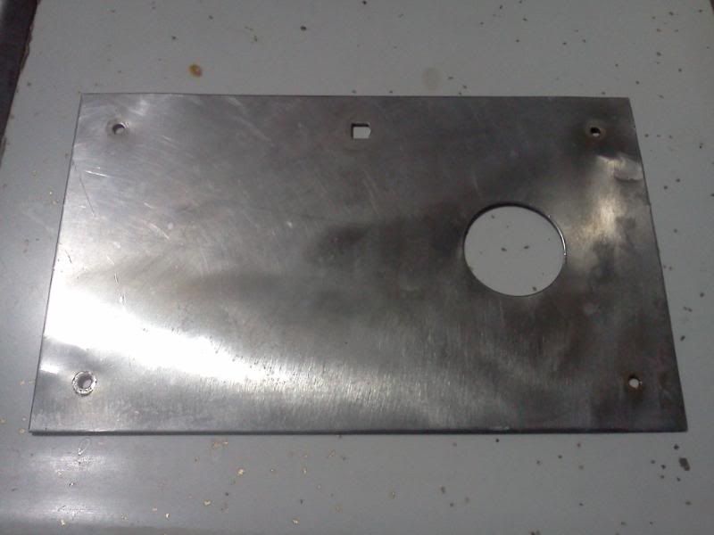

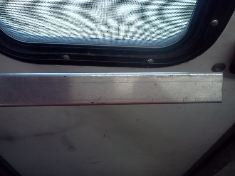

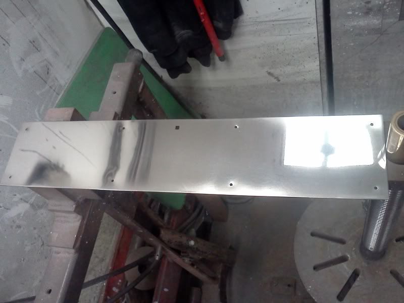

I am starting to work on my Stargate cocktail which ill be trading to a friend when Im done. I started on the kick plates. I wanted them to stand out and look near new so I decided to polish them. Here are some before and after pics. Let me know what you think. I can offer this service also for kick plates, brackets, control panels, pinball coin doors,ect. All items will be clear coated also. More pics to come after I polish the larger kick plate portion on this cab.
Before
After
wow, that's quite a difference, very nice clean up job. What technique did you use to get such a high level of polish and shine?

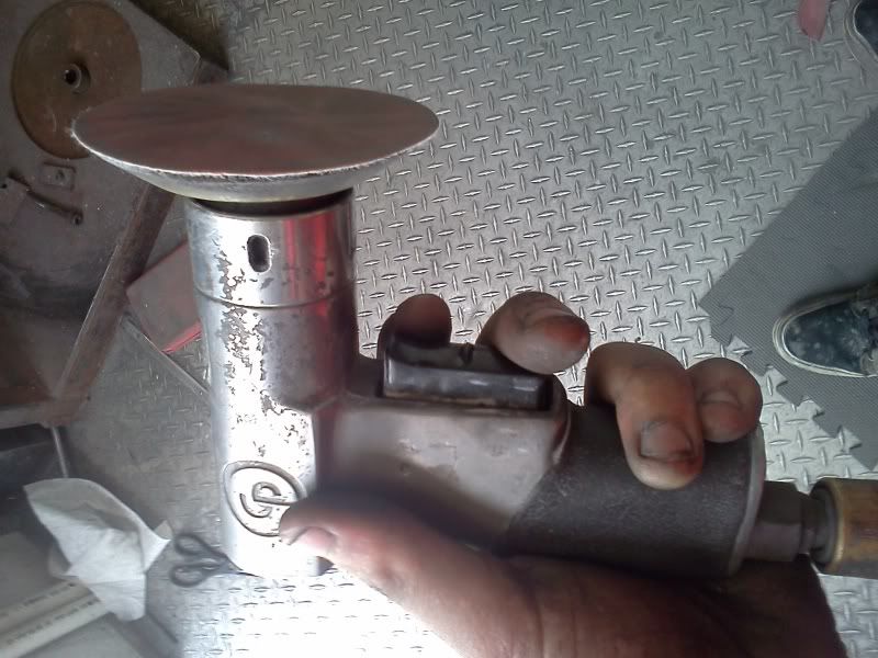

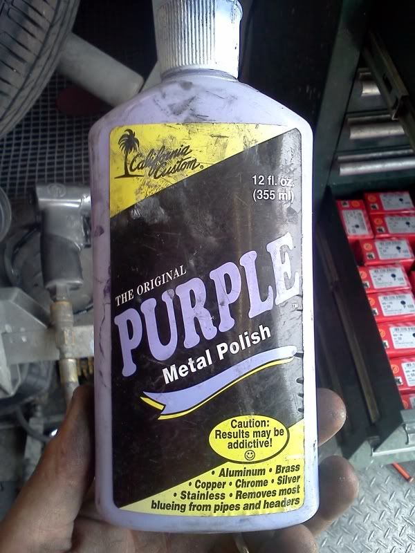

I used this and went from 400 grit to 600 to 1000 to 1500
The I finished it off with this using white scotch bright on the end of the sander
