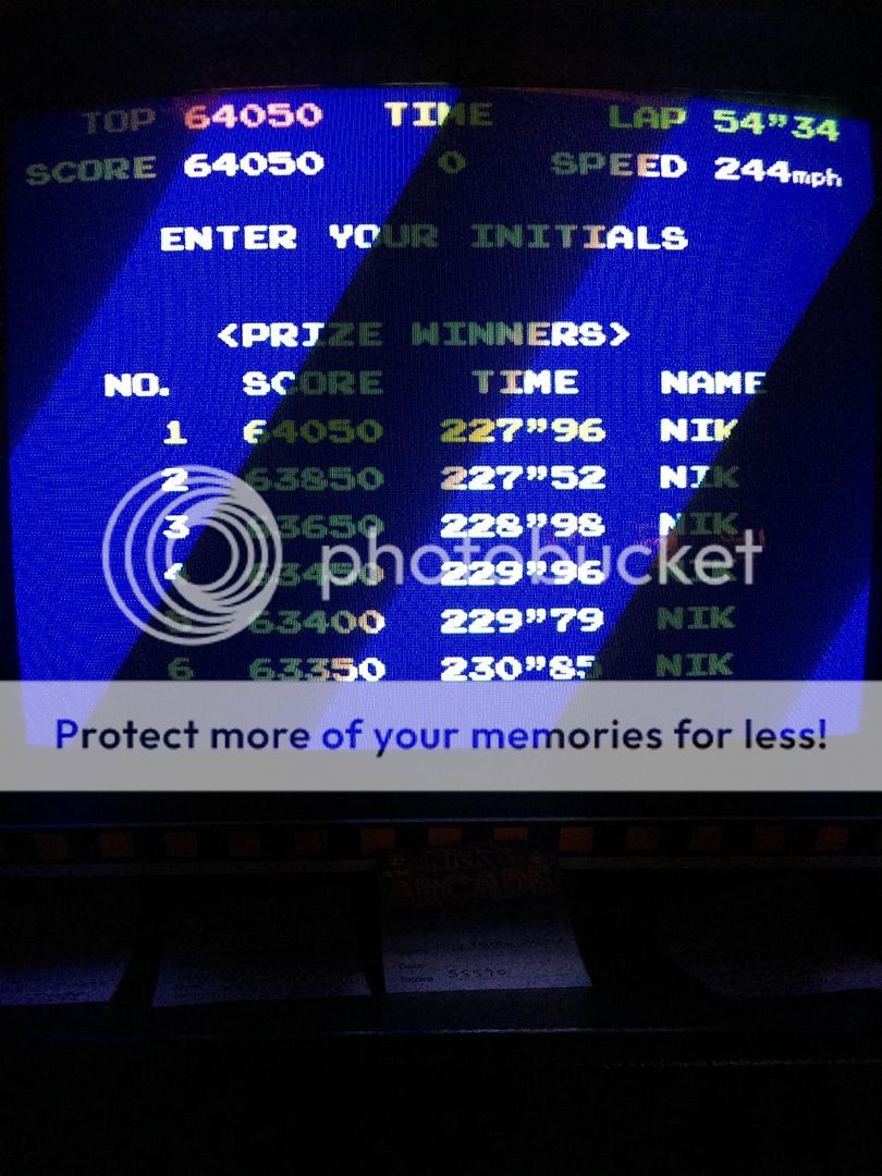

A lot of playing lately. Addicting as hell. I went ahead and ordered a pedal cable and the round pulley it hooks to from arcadefixit because mine's a bit rigged up.

Legit scoring there pal, nice job.

I just replaced my cable and springs. I'm now maxing out at 98. It was at 95. I just got my first 65K game.
I've never once seen a 245 mph though.
This is what was on the inside of my accelerator pedal. As mentioned in another post, ops were rigging these to last longer. I have now switched to a pot, cable and spring like it's supposed to be. Now my test actually shows movement up and down on the scale depending on how hard the pedal is pressed where it didn't do that before. Mine will now go in the 90s past 99 to 9A, 9B, 9C and finally 9D when pressed all the way.
I notice my car gets up to speed a bit faster than it used to.
