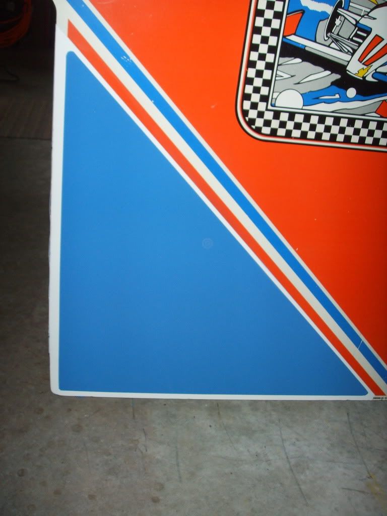

and see what the damage was. Well, it was bad. Whole corner was busted out and crumbling, but only about halfway into the particle board, meaning I could easily bondo it. Which I did. Then I recut the T-molding channel with my router. When the bondoing, sanding and slotcutting were done, I realized I would have to color-match the white and blue in the side art and touch up those areas. I ended up masking around the blue triangular field and spraying 3 coats of Rustoleum 'Sail Blue' on it. I then waited 3 days and masked the blue field off and sprayed Rustoleum white fusion paint on the area around the borders of the blue field. When I removed the mask, it looked pretty sweet:
Though you can see where the bright white ends and the faded white of the rest of the side art begins (at the top and right angles of the triangle). I will be masking the rest of the graphics with frisket when I get the chance and hitting all the white areas to make it look uniform and complete.

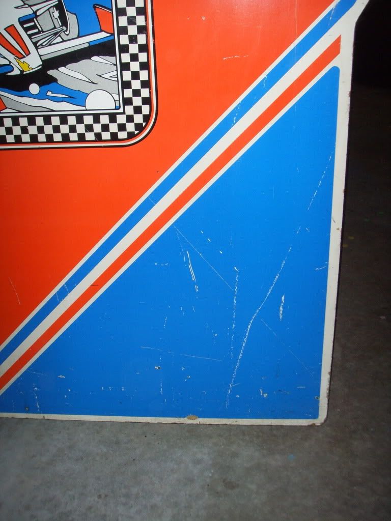

Here's the untouched side:
vs. the repainted side:
Pretty close blue match, and it looks better than scratched up torn and otherwise old blue vinyl. I will be masking and painting the unfinished side when I get the chance. I then decided I should remove the CP, clean and lube the steering column and remove the old CPO and repaint the metal. I then decided that I would use a Willis overlay I had picked up on eBay for $5, which, to me, really matched the Pole II marquee colors better than the original Pole I overlay:

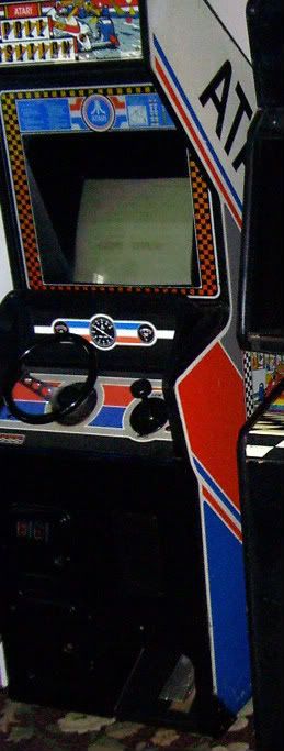

So after that was done, I figured I'd post pics. I will touch up the rest of the side art and apply new T-molding when I get some time from my other restoes. Until then, it is looking pretty good:
