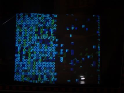

Hello all, I just bought a Pole Position and when I turn it on I get the screen below. I hoping someone can point me in the right direction to start. I'm kind of new at fixing these so any help you can give would be great. Also if anyone is in the Seattle area and would be willing to let me help them fix some games so I could learn that would be fantastic.

Hey Phil, you picked a whopper for your first repair. Pole Positions are notorious for going bad. You're not far from one of the better Pole Repair guys, Dick Millikan. He's a Washington State resident and a member here. He can help you.
Start with the edge connector that connects the video and cpu boards together. I had mine all the way on and got that screen, i backed it off with the power on until i heard the explosion startup sound. My needed to be in a really specific position to work correctly.
Thanks Fudd. Easiest fix ever. I pulled the boards out and the connector had completely fallen off. All I had to do was put it back on and now I have pole position!! I'm super excited about this one. Thanks for your help.

I wish mine was that easy. I got my board connector, so now I can see all of the pretty zeroes on my screen. :)
