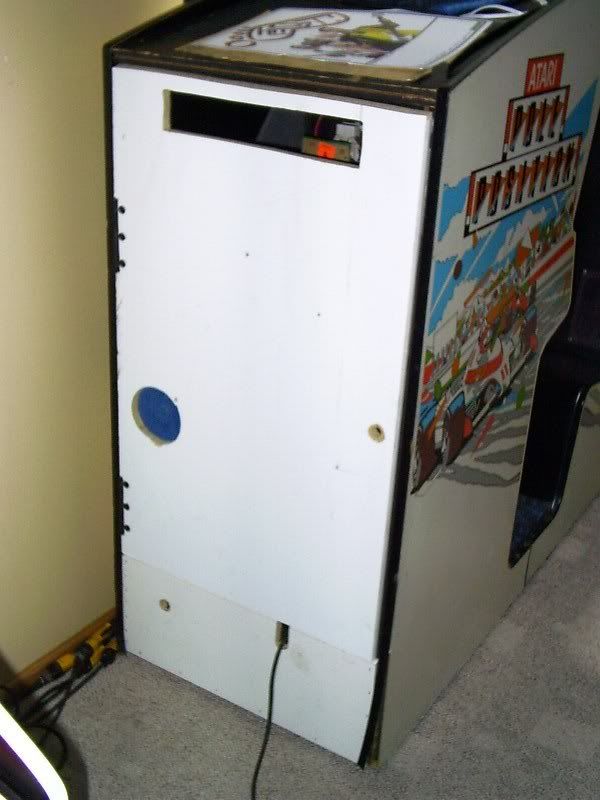

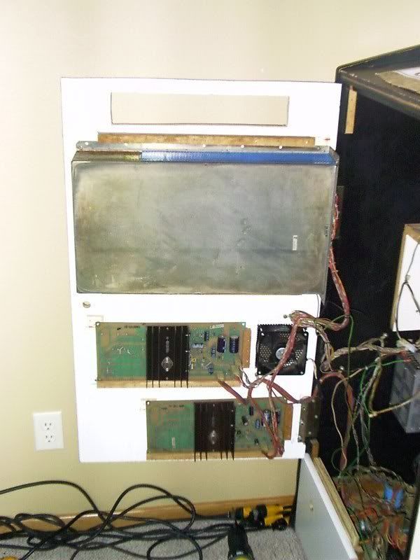

And here is a pic of the inside of the back door for you:
Is that a factory door? It's the 3rd style of ventilation that I've seen so far. And looks like yours is also missing the cage cover for the end? I wonder if those things were just commonly tossed back in the day.
Nope, my factory door was a swelled up, mildew-riddled pile of crumbling crap. That was my CNC and routerless attempt at a replacement, using 2 ft wide melamine shelving. I used the factory door as a pattern, so it's pretty close to spec. Now that I have a router, I'm gonna try again at a later date.

Phet, I'm pretty sure mine is factory because I've seen another door that has identical vent/fan holes yet it doesn't look like yours. Plus the cab I got my guts from had a different venting scheme, but that one may not be factory for all I know. So I'm thinking the factory had at least 2 schemes they used. The mounting scheme for the boards seems to be identical on all 3 though.
