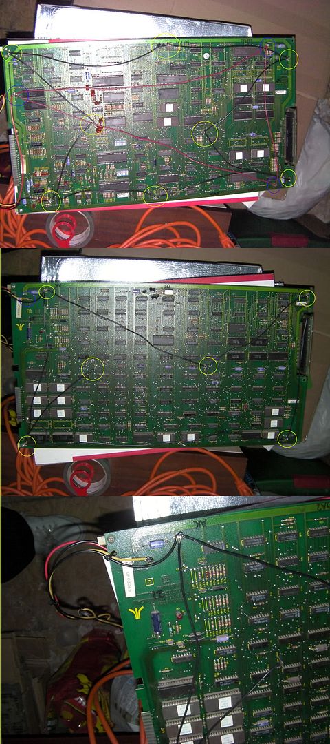

I've had a few people ask me to take photos of my Pole Position PCB and to describe what I've done to mod my Pole Position PCBs. Please note that (A) I didn't discover/invent the modification... I found one mod (the power distribution mod) already done to my Pole Position PCB... and the board was marked as being fixed by Dick M... I am not sure if he did the mod or if someone after him... that is just how I found it. As for the switcher mod, I read about it online somewhere.
I have no idea if these mods help keep PP PCB's stable or not... I just know that I've modded both mine and I have had ZERO trouble with both PCB's in the year and a half or so since I've had them.
Anyway, here is what I did:
The YELLOW circles indicate GND test points on each board. The BLUE circles indicate +5 test points on each board. Note that there are 3 test points on the front board and 1 on the back... I used RED wire for the power on the front board and YELLOW wire for the power on the back and GND is black on both boards. The word on the street is that this mod distributes power more evenly than just using the edge connector...
Now it comes to a point where you have options. Option (1) would be to solder the +5 and GND wires to their perspective pins using the edge connector... or option (2) is what I chose to go with... which is to wire in a switcher power supply to deal with the +5..
What I did was I used a standard 4-pin molex connector... I wired 2 positions for ground and 2 positions for +5 for both the board side and the switcher side. I then removed all existing +5 power coming from the original linear power supplies in the cab... though some have said that is unnecessary... I did it anyway.
So the original power supplies still pump out the +12 and whatever other voltages are necessary... but the switcher supplies the +5 via the molex connector...
Pretty simple and straight forward... and like I said, my cab has been running this way with ZERO issues for about a year and half now.

i simply put in a switcher to run the +5v's and grounds. 1 +5v on each side and one ground on each side using spade connectors like mark said. i cut the connections from the harness and mine has been solid since. running all those wires is over kill but works the same.
This is what I did to my PPII board and I didn't have any problems for 3.5 years

It's his opinion (and likely fact) that it's overkill and unnecessary to run the wires from test point to test point. He simply suggests running a dedicated power and ground line from the supply (be it the linear PS or an additional switcher) to a test point on the front and back boards (one +5 and one GND per board). The test points are designed to accommodate a spade connector so you could eliminate all the wire and the molex connector by just wiring to 4 spade connectors (again, 2 +5 and 2 GND) and plugging them directly to the test points on the boards.
Now as for my opinion... I don't care how ugly it is... so the extra wire doesn't bother me... even if there is a .0001% chance it helps keep the board stable and running... it's worth it IMHO...

I did a hybrid of several of these methods. I used the quick disconnects on a couple of the test points for each board but I wired them to a molex connector. And then wired the molex connector to the original matched AR-II board. I did not remove the +5 and ground wires from the harness either.

Frizz, How did you integrate the switcher?
I'm going to try the mod on my PPII but I am undecided about adding the switcher...how did you do it??
bolt switcher in
take 120v line that runs monitor and connect to switcher
take monitor power line from chassis and connect to switcher
make 2 +5v lines and run to each side of board to test points
make 2 gnd lines and run to each side of board to test points
cut lines that run the +5's from the harness.
done.
