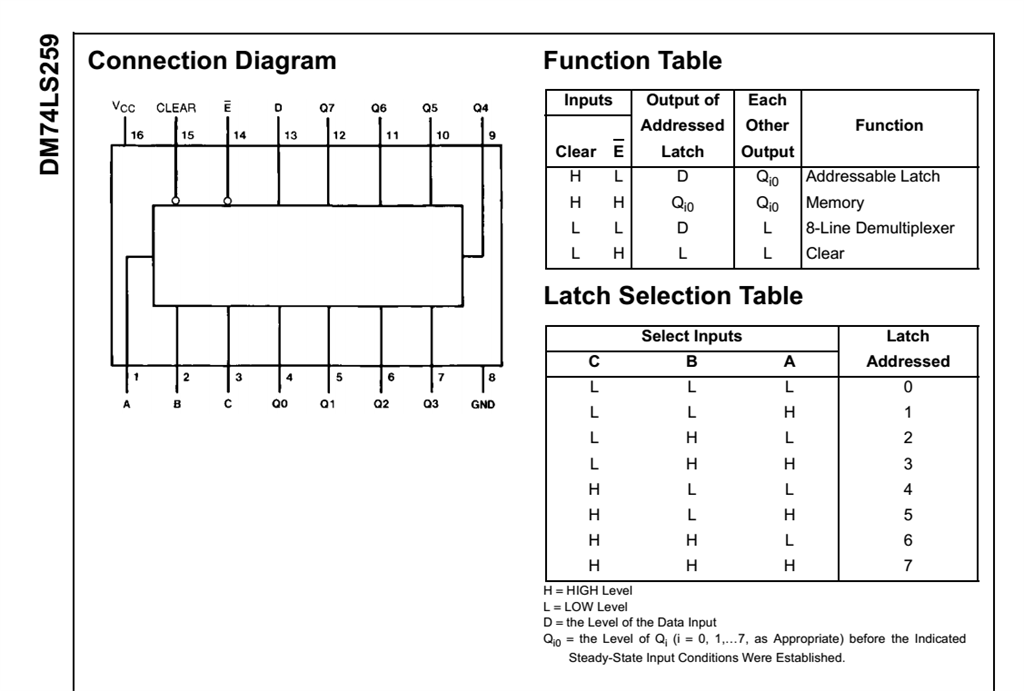

I would think that if any of the pins in 1, 2, or 3 pulsed then you should see a change on Pin 7 unless I'm reading the datasheet wrong.
What are pins 13 and 14 and 15 doing on 8E?
Yes, I did read it wrong...
Looking at that pin 7 is Q3, which is enabled by pin 1 being High, pin 2 being High and pin 3 being Low.
If pins 14 and 15 are High, then you should get output on pin 7.
Might be tricky to test as you have to figure out if both 14 and 15 are high at the same time.
Not sure what the "Each Other Output" means. Maybe that if 14 is Low and 15 is High you'll also get something on pin 7.
14 is pulsating hi...15 is solid hi....7 is now solid low.......in the last two hours pin 7 is testing either solid hi or solid low ..(solid meaning no pulsing or beeping..its a solid steady tone)
Its the same in attract or coined up.
Well, that's good. So you said that pins 1, 2, and 3 are pulsing? (you said High with a pulse, not sure if you mean they are pulsing)?
If they are pulsing then I would suspect 8E as bad. If they are not then maybe an issue with 6J.
