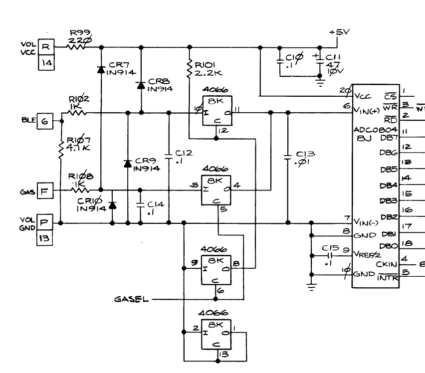

Pole Position : no acceleration .. Gas pedal not responding

3 - I did not logic probe anything on 8j or 8k. I was too discouraged to go further so i shut it all down until i get new ideas/suggestions what to do next...maybe replace 8J next?
This is the next logical step. Break out the logic probe and start at pin 6 of 8J and work your way backwards. See further below....
4 - i picked up a 5k volume pot from radio shack thinking that may work in place of existing pot...after i replaced 8k i had zero gas with the new pot....so i figured maybe that new pot wouldnt work because its for volume? ??..i dunno..seems like it would work, right? Anyway, i then removed the new pot and reinstalled the original pot thinking with the "new" 8k the original pot may be needed in the game...zero luck..no gas.
I don't think your existing POT is the problem. Even with a bad spot in it, you should get something. Might not be the full throttle, but at least partial or intermittent.
So maybe now i will order a new 4066 for 8k and may as well buy a new chip for 8j.
Hold off on this until you've checked the rest of the circuit with your logic probe. You might be chasing something that isn't the problem.
Pin 6 of 8J is connected to Pin 11 of 8K. So you want to use the logic probe on Pin 10 of 8K which is the INPUT side of things and Pin 11 is the OUTPUT side of things (The diagram above has them reversed, but that's ok).
Pin 12 of 8K is the control between pins 10 and 11. If Pin 12 never changes then 10 and 11 will never be connected (or always connected). So if Pin 12 is pulsing and pin 10 never changes, then you follow Pin 10 back to C12, CR9, R101, R107, R108, etc... you want to make sure the resistors are within spec, the cap is good, etc...
If Pin 12 is NOT pulsing, then you follow pin 12 back to pin 8 of 8K. Pin 8 and 9 are the OUTPUT and INPUT and pin 6 controls those two.
If pin 6 isn't working then you follow it to Pin 7 of 8E (page 12 of the schematics) which is an LS259. If that's not pulsing then 8E could be bad.
Hopefully that should be enough to get you going. Gamefixer can correct me if I'm wrong since he knows more about this than I do :D

That is pretty advanced....but i need to tackle this...the only way i can learn. Thank you for laying it out for me.

Well i messed with it a little tonight but didn't do any of your suggestions just yet because i didnt have a lot of time....
Anyway...i wanted to do a continuity test from the tabs of the pot to the edge connector and to the 8k and 8j.
So i put the black lead on the tab ofvthe pot where black lead is soldered....touched edge connector for that black wire and got a beep....then i touched leg one of 8k and got a beep....so from pot tab to chip 8k i got a beep and beeps on a few other legs on 8k and 8j.
I then put the lead on tab with red wire soldered to it....then touched edge connector where red lead goes and got a beep...and i go to touch legs of both chips and got no beeps.....so i touched the back side of edge connector to front of connector where it slips onto the board and got a beep...so the connection is there between connector and where it slips on.
Should i get a beep on the red wire to either 8k or 8j? If so, then that may be the issue since im not getting any continuity.

If you mean Pin 1 of 8K then that is Ground and you should get a beep. As for the other legs, it would be important to know which ones.
Also is it a continuous beep or just a quick beep? If it's a continuous beep then that means it's a dead short (no or very very little resistance) between the points. For ground that's good if there are no components between point A and point B.
But say you are testing from the edge connector pin F to pin 3 of 8K, you should NOT get a continuous beep, just a quick one (depending on your meter). If you get a continuous beep that means that R108 is probably bad. Your meter should show around 1K of resistance (might be a little higher or a little lower, but close).

Without knowing the locations you are testing it's hard to say.
Testing from the pot to the edge connector is good for testing the harness to make sure it's good, but depending on where you test on the PCB, will determine whether or not you should get beeps.

I get continuios beeps on legs 1 and 2 of 8k....and a few others...i will re check today....on 8j i get real quick beeps
All of this is with black wire from pot....red wire i get nothing.
Tonight after work i will list each leg and what i get for continutiy.

Also, if it means anything, i tested the following below with the logic probe:
R99 - tested both legs...both stayed solid hi with no pulse
R102 - tested both legs...both stayed solid low with no pulse
R107 - oops..forgot to test this one
R108 - tested both legs ...both stayed solid low with no pulse
CR10 - tested both legs...both stayed solid low with no pulse
CR7 - tested both legs, + side stayed solid high, no pulse...other side stayed solid low, no pulse
CR8 - tested both legs, + side stayed solid high, no pulse...other side stayed solid low, no pulse
CR9 - tested both legs,...both stayed solid low with no pulse
C14 - tested both legs...both stayed solid low with no pulse
C12 - tested both legs...both stayed solid low with no pulse
C10 - tested both legs, + side stayed solid high, no pulse...other side stayed solid low, no pulse
C11 - tested both legs, + side stayed solid high, no pulse...other side stayed solid low, no pulse
C15 - tested both legs, + side stayed solid high, no pulse...other side stayed solid low, no pulse
C13 - tested both legs...both stayed solid low with no pulse.

I wonder if "GASEL" is actually Gas Enable? Seems kinda silly to have that but it was low in your first posted video. start a game and see if it goes hi.
Pin 5 and 6 on 8K.

Agreed. I think if that's low, 8K won't do anything.
Could he manually pull the pin high to test that way?
Sure.
I like to start with something like a 470 ohm resistor when I'm trying to force a pin one way or the other. If that doesnt work you can move all the way down to a 47 or so ohm resistor. What you dont want to do (unless youre sure of whats going on with that pin) is tie is directly to GND or +5. Reasoning is that lets say the chip that drives GASEL is internally shorted to GND. If you tie that pin to +5 you are probably going to burn the trace open and might even pop the IC. If the IC is bad thats no big deal but burning the trace open would suck.

I just tested GASEL on my board on the bench. During power up it was low, at the explosion sound it started to pulse (switch between hi/low). In test mode it pulses and my gas pot works. If I hold pin 6 low I get no gas pedal response in test mode.
I'd look at that GASEL signal and see what its doing.

Is gasel pin 6 and 5 on 4066?
If so, i should hold probe on pin 6 or 5 then start the game and see what the probe does?

Yup, 5 and 6. Start a game, put it in test mode, either one should change it to pulsing from the looks of things.
Pin 5 and 6 both stay solid low when i turn the game on and stays that way. I set logic probe on a leg..turn game on and instantly is low...not even a glimmer of a change.
I also switched the game to test mode with the logic probe on the pin and nothing changed. I also started a game, and same results.
I did this for 5 and 6 individually.
Then for shits and giggles i put logic probe on back side of edge connector to black wire...it beeps low...i press the pedal...it stays low...i then put logic probe on tab with black wire on pot...stays low.
Then i put logic probe on back side of edge connector to red wire and it stays high....i press pedal, and stays high, i put logic probe on pot tab which red wire soldered to and stays high when i press pedal.
Shouldnt probe change from high to low or visa versa at edge connector or pot when i press pedal?

So i have a high (red wire) and a low (black wire) signal going to F of edge connector.
