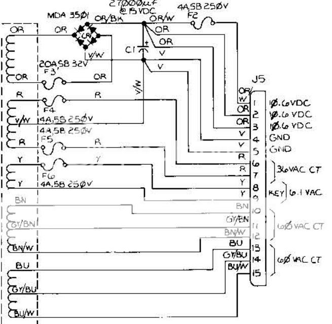

I have this (sorry, blurry phone pic):
I know I have to measure the voltages coming off of that thing, but not sure where..
There are the points at the fuses, and then there is the block where the plugs go...
The smaller 3 wire plugs are 110V, and those are good..
I thought I had possibly measured across the ones where the fuses are (assuming they were DC), but it turns out my multimeter (analog) isn't working.
My digital is tho, and I realized that I have no idea what voltages are there....
My manual has no voltages, but I found this:
http://pdf.textfiles.com/manuals/AR...h Printing) [Schematic Package] [English].pdf
And page 3B has (I think) what I might need, but...
I'm totally lost looking at it and trying to compare it to my PSU...
I basically have no idea where I need to test and what voltages I'd be looking for...
desiv
You want to measure on the molex in the lower right of your photo. Just shove the test leads down there. Consult the schematics for the correct pinout so you can tell what is what.
The schematics don't show the pinout for the molex connector.
They show wires numbered 1-15..
They do list colors, so I suppose if those match, I can go by that..
At least for the DC voltages.
The AC's don't make as much sense.

Don't worry about the center wire as it is usually the center tap and has little or no voltage. The key here is to have the meter set to AC voltage and high enough to see the voltage.
Going by the drawing you posted here R to R which go to pins 6 and 7 of j5 should have 36 volts ac
Y to Y should have 6.1 vac pins 8 and 9 of J5
BN to BN/W should have 60 vac (volts ac) pins 10 and 12 of J5
BU to BU/W should have 60 vac pins 13 and 15 of J5
If you look at the top the thing with the pointers (diodes) that is the only part that has the DC voltages.

OK, I don't think it's my digital multimeter...
All the AC voltages tested out right..
I test a AA and I get 1.544.....
I go back to the DCs, and it goes to 12.45 and climbs really slowly....
So, as long as it's plugged in, the DC voltage starts too low and climbs really slowly, but it just keeps climbing....
So, I do some checking..
The V(iolet) wires go into the Big Blue, as do the OR(ange) wires (and the OR/W, which goes to a fuse first).
They also are attached to a square piece of electronics which I assume is a voltage rectifier.
So, next steps?
I'm thinking possibly get a new Big Blue?
I don't have a meter that can test a capacitor.

Your problem is likely to be F3 and its associated wiring.
They always burn up the clips and melt the wires.
Go to a car audio store and pick up a 25 amp fuse and holder and wire it in.
(Yes, 25 AMP was recommended later on by Atari)

I've tested the connectivity at all the fuses and it's good...
Could a problem with the F3 connection cause a multimeter to read voltages increasing like I was seeing???

I started with the first DC measurement.
It started around 0 and started climbing up.
It should get to 10.6VDC.
It's at 6.59 now, but has been REALLY SLOWLY climbing for 10 minutes or so...
It's at 6.72 now...
So it's still climbing...
Hopefully it will settle in around 10.x or so.. (stop climbing)

I would check the batteries in the meters, it is a common problem that gets overlooked quite a bit.
Make sure you are measuring the DC and not AC with the meter. Replace the batteries and re test, report back.

The only dc voltages are pins 1,2,3 to ground all of the rest are AC.

If it is not the meter, I still suspect a bad meter, then the diodes are probably bad but the readings are very strange. How does the meter do with ohms measurement?
The test is with power off.....
http://www.allaboutcircuits.com/vol_3/chpt_3/2.html
EDIT:
Plant the black lead to a ground and measure with the red lead to pins 1,2,3 on dc voltage at about 20 volts dc
