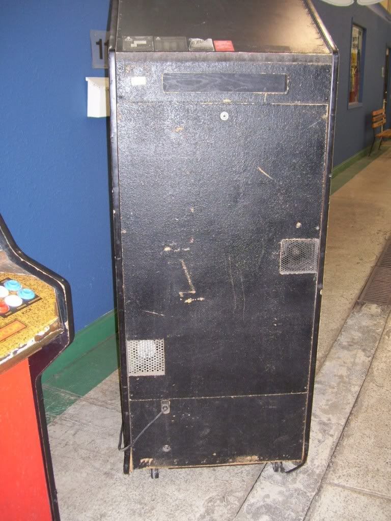

Usually there is a hole in the back door of the newer cabs. There is a cardboard duct located over the cage and a 4" fan mounted at the rear blowing outward. I would snap a picture but my cabinet has no fan (or back door), I have yet to start work on mine as the wiring is a total mess.

Here's a back shot of my working Pole Position before I cleaned it up inside and painted the back. It has 2 fans with cutouts and also the cardboard on top of the game boards. A switcher has also been installed to bypass the power supply. Game runs great, boards and connectors look good also with no burns.
