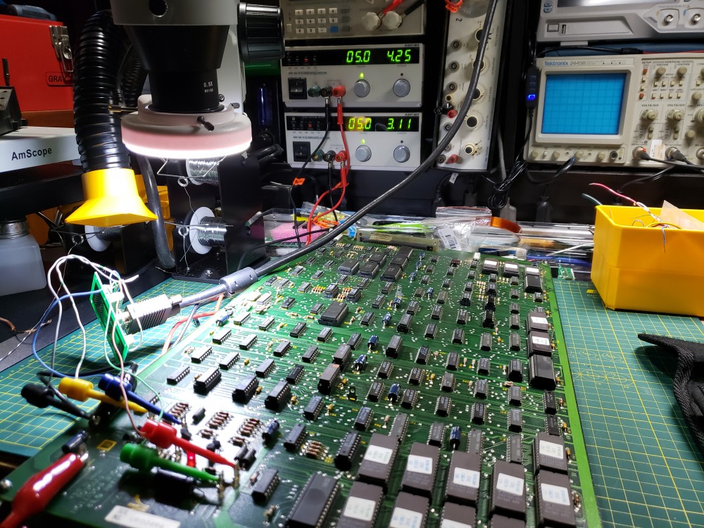

To be more exact, each PCB, the VID and CPU take approximately +5V @ 4A. That is near the limit for the discrete linear regulator (and edge connector pins). So, two ARII are needed - one for each board. (As time progressed, and newer games / boards needed more power, Atari did start to use switching power supplies and dedicated audio amps instead of their "tried and true" Audio/Regs. For PP in 1982, they used what they knew and had available - you could argue it was a good available technical solution that was also cost-effective).
Here, on the bench you can see the approximate loading of a working pair ->
