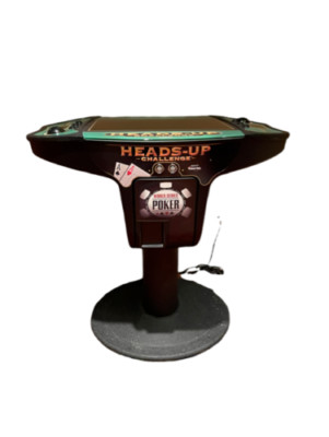

1
I have one of these machines in my house. All i can get out of it when i give it power is a NO SIGNAL on the main monitor. I found out that there was a graphics card issue with them so i purchased a repair kit off ebay which came with a new custom graphics card and a USB.
It has made no difference and i still have the same issue. Ive been told that the main board is probably the problem so im after a main board or any idea what else i can do.
Im poker mad and this for me is the absolute nutz so i refuse to give in and need it fixing.
any ideas folks?
The link is the repair kit i purchased and the guy sent me a full factory manual for it aswell.
Anyone have a board or clue ?
Thank you!
Shane
I brought one back from the dead awhile back, and it really helps if you have some PC building knowledge. Is power getting to the motherboard? If not, you'll need to replace the uncommon 24/12/5V power supply.
My "No Signal Found" was caused by bad RAM and/or bad RAM socket that wasn't registering the RAM. IIRC there are two slots. If you have more than one stick, swap them, then select one or the other. If you still have problems try to buy known good RAM (eBay, etc.).
