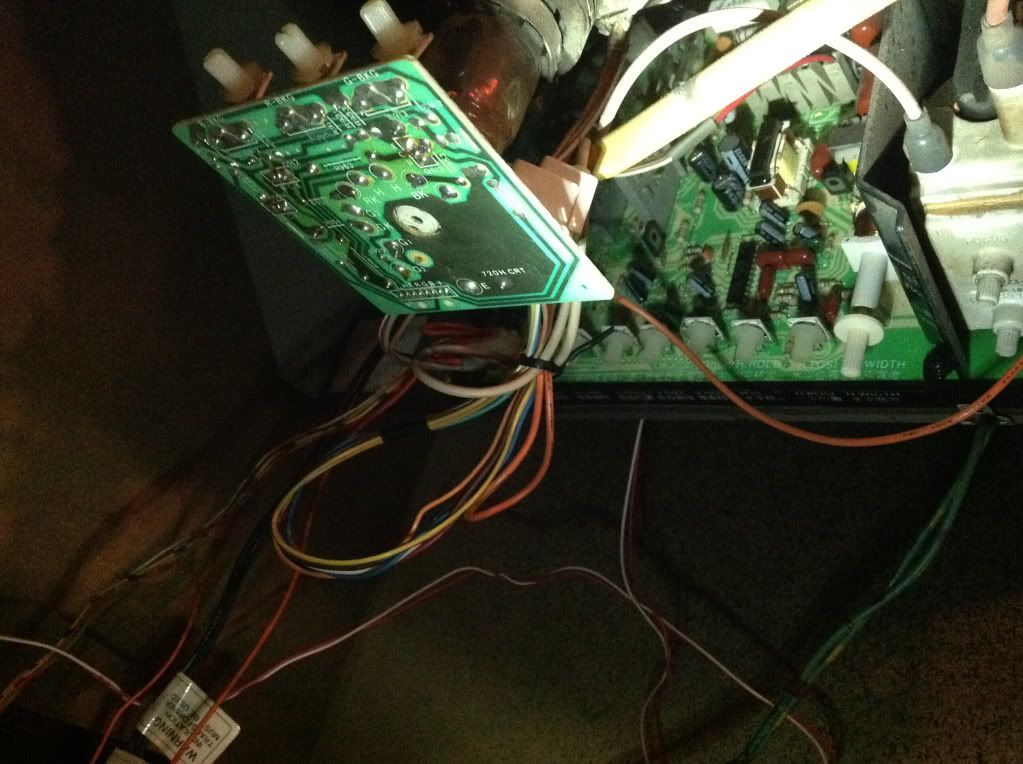

plz help me identify this monitor!
rabidewok
Feb 16, 2011
597
6
League City, Texas

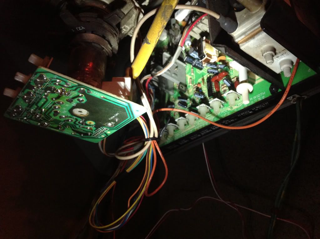

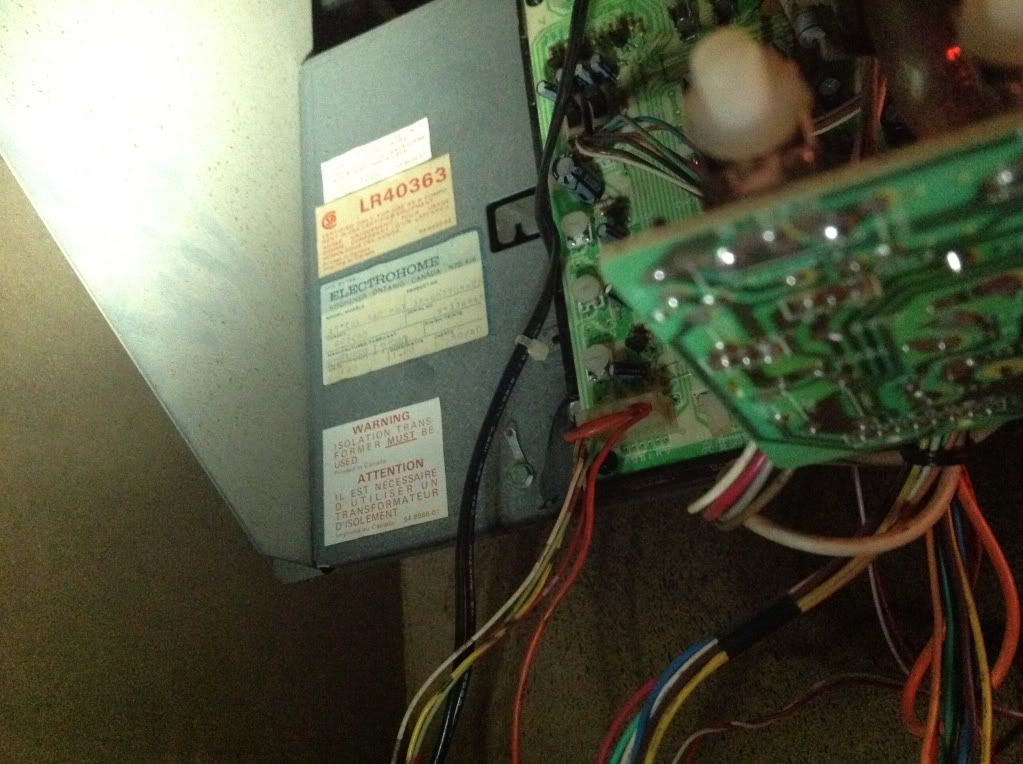

Just bought a Pac-man plus, There is no red showing, plz help me identify this monitor and chassis so i can replace it. thanks so much..... Or if you know which capacitor i need to replace for the red, then i will try that. The metal frame shows G07 but im 100 percent sure thats not true. Any help is appreciated!
There may have been a slight mod to the yoke wires or connector.. Or at least there was on the few I have on go7 frames/tubes.. Take a look at the yoke wires.. Red, blue, yellow, green or brown..
If your missing red, 99% of the time it's one of the trannies on the neck board.. Test all three with a meter and reflow the solder.. As it might just be loose.. If it reads .01 or .03 on any of them, it's toast.
