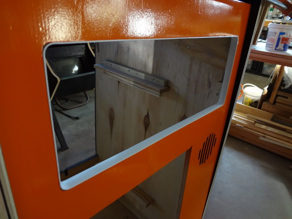

I've got a "working" Raystorm on location that got it's front kicked out when some douch broke into it. I'd like to use A grade plywood and cover it with sheet vinyl. 1) Where do I find some matte or semi matte vinyl, need about 36"x 30" 2) Will the wood texture show though, should I prep it with paint or varnish to seal it for a smoother finish ?

I am in the middle of this controversy right now. I chose to build my first 2 Nintendo cabaret cabs out of plywood, and even after 2 coats of primer, 3 coats of paint and one layer of vinyl, the plywood's wood grain is still discernible, as are any, and I mean any, imperfections. Dry spots, knots, football plugs, cracks, etc. Plus plywood tends to start crowning and bowing like a banana boat if not constantly weighted down by 1 metric ton of pressure per square inch. My next 2 will be built with particle board.

You can pay a few dollars more per sheet and get the stain grade plywood and not have to deal with any knots or cracks. Actually, a few light and quick sanding is all that is needed before priming. I know $40 a sheet can seem like a lot but it makes all the difference in the world on the finished product.
That is what happens when you use cheap plywood. Get the cabinet grade plywood for projects like this.
If you can run your hands over the face of the plywood without worry of getting splinters, then you're on the right track.

I've been building a cabinet and I used some cabinet-grade plywood that was on sale at Home Depot for only $25 a sheet for 3/4" 4x8. I want to say it is probably equivalent to an A-B grade, but I'm guessing it is a birch on the faces. The grain isn't small/tight like an oak plywood would be (but also 1/3 the price...).
I sanded the sides even more with some 400 grit, then applied a few coats of Kilz primer and sanded in between each coat. Now after a a few coats of black latex paint I can't see any grain. Each coat of black I alternated the stroke direction of the brush, so that tended to "even" out the look, too. Overall I'm happy with it, but if I used a spray-gun I probably could have gotten an even smoother finish.
Anyway, I think the key in my case was the additional sanding and multiple coats of primer to help create a good base for the final color.

I learned after my first total rebuild that the wood makes a big difference. Don't get regular 3/4 ply, no matter how much you sand and prep it will never be up to standards. Spend the few extra bucks on cabinet grade and you are good to go. I will never use MDF or particle board because of weight and moisture problems. I have also never had a problem with routing the t-molding channel, as long as you have a good bit you shouldn't get any chipping between layers.

However, the quality of the material you start with will show in the final result every time. Go with A grade cabinet plywood where plywood is needed, use a nice building primer from your local auto parts store and with a tiny bit of patience you can get every hint of woodgrain out.
